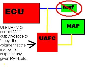

    Hi I've been looking at options for converting to MAP and really haven't found anything that doesn't involve switching to standalone. I want to do this and have it running properly before I install my turbo setup. So far all I can think of is using a UAFC from 14point7.com (http://14point7.com/UAFC.php), basically replace the MAF completely and use a Motorola MPX4250AP. The reference signal is 0.2v to 4.9v, and I would use the UAFC to correct the voltage and in turn the AFR. Anybody have any thoughts on this setup? This is my first time really messing with fuel injection things (learned about cars working on my fathers carburated muscle cars,) so please excuse me if I have this ALL wrong.
    Kind of like this:
    Thanks in advance, Angelo.

      E30's are actually a good canidate for MAP sensors because the AFM works on a similar principle (speed/density). They do not have a "MAF". You could do it with something like tunerpro/ostrich, but it's going to require a bit of R&D and hacking on your end.
        I am actually planning to use an ostrich for timing adjustments. Would I be able to take the signal from the map directly to the ecu and use tuner pro to compensate for voltage change?
                          yes, that's how I would do it. you need to figure out how to do it, but I'd avoid using any signal "translators". Map sensors can be noisy on M20s as it is, without adding an additional step between the sensor and ECU.
                            May I ask what you mean by "noisy?"

                              the pressure waves in the intake manifold - at peak torque where the pulses are strongest, the MAP sensor picks these up and you see it as the pressure rising/falling dramatically within a short period of time. When the average pressure is much closer to atmospheric (assuming WOT).
