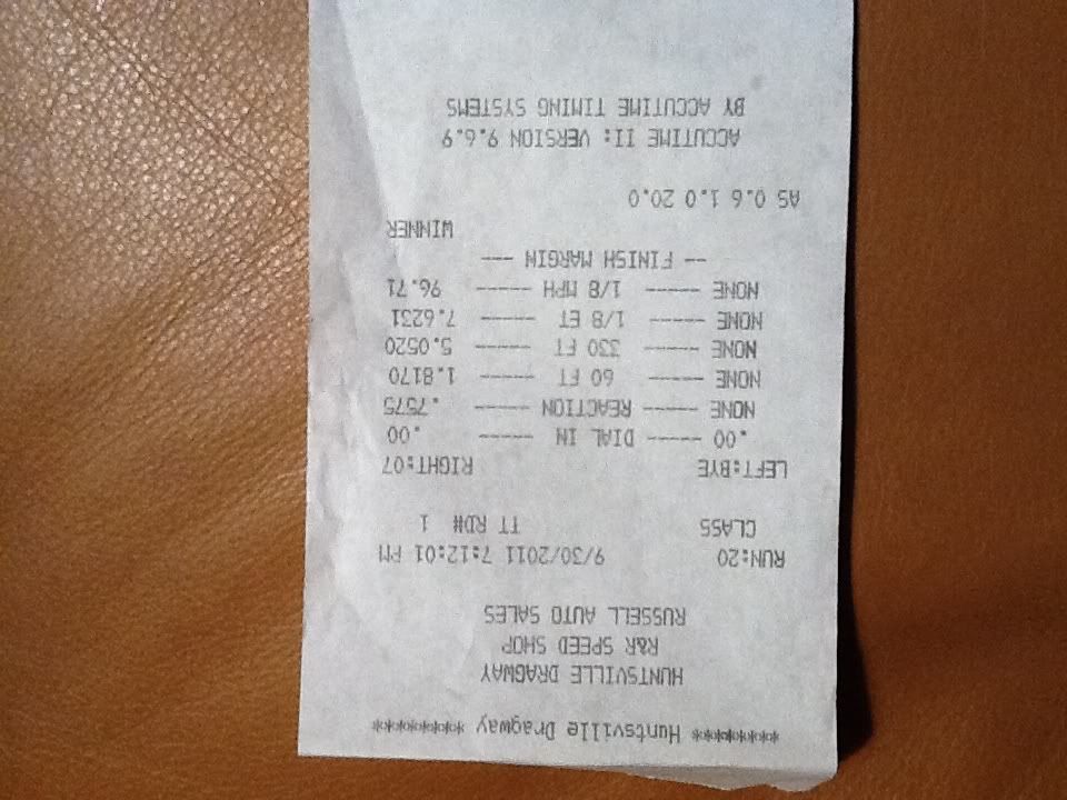

    I completed a major purchase on tires, so will just post up some YouTube videos of the car and my 12.30 second run I just completed this weekend.

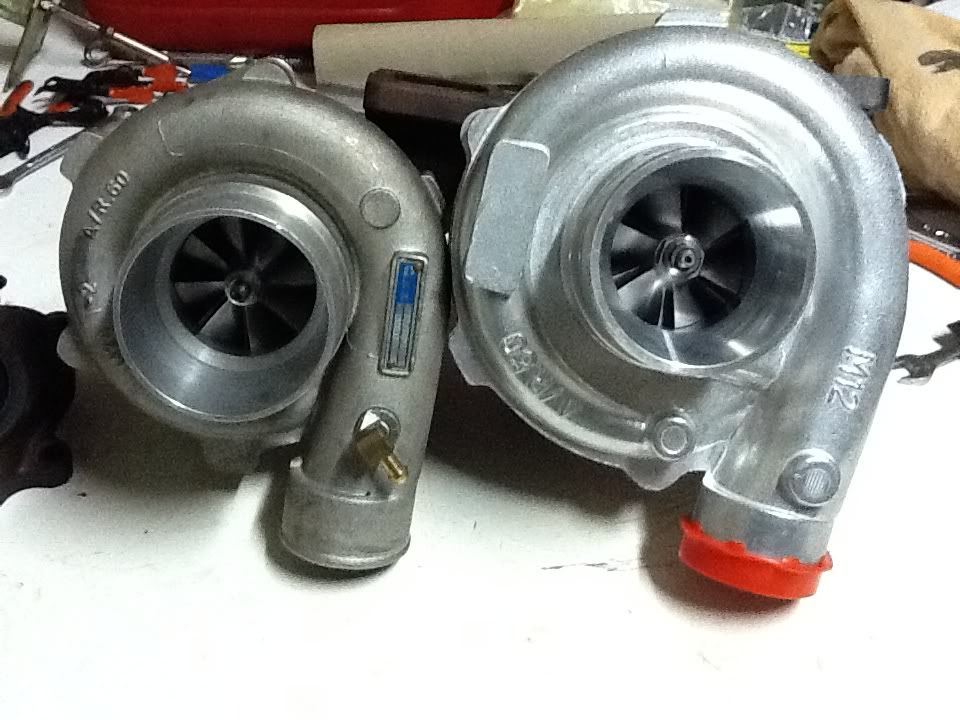

                  Just to give a little update to my build. My t3 eBay turbo died the other day, so instead of a rebuild kit I spent $109 on this t3t04 hybrid.
                  The net result at 24 psi boost is 0.32 seconds quicker in the 1/8 mile.

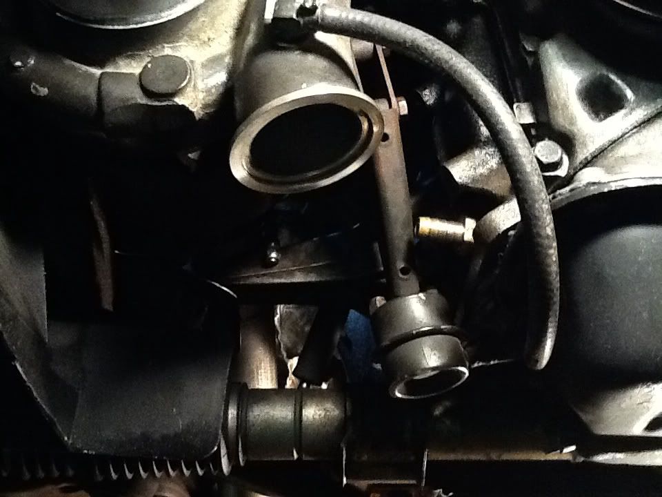

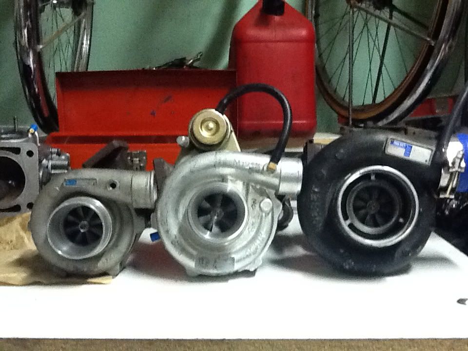

                            New turbo trial fit, also showing the oil drain.
                            Hx35 from a 1997 dodge cummins, the WG just misses the engine.

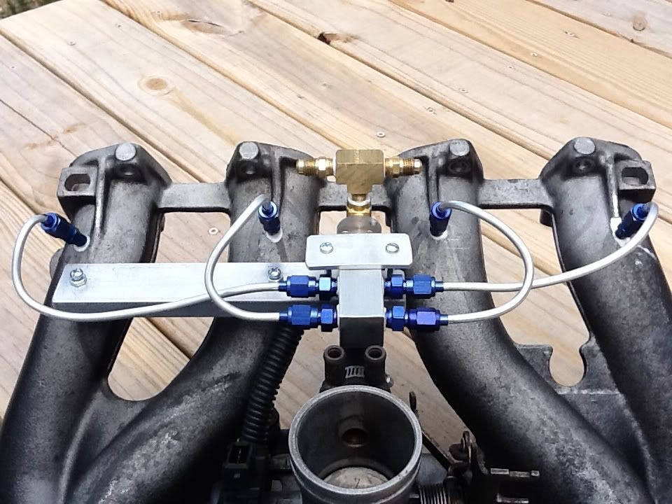

                            Along with the holset, I also added two stages of direct port methanol injection.

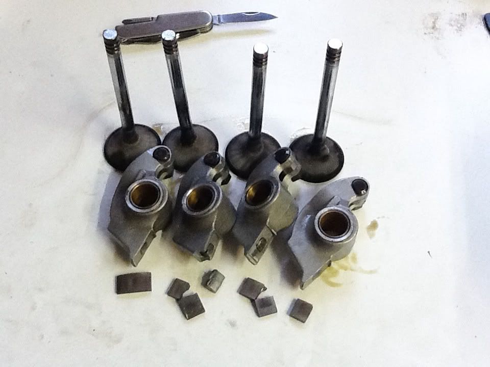

                            With the Above mods I made a 364 whp dyno pull at 30 psi and three hits at the 1/8 at 29 psi. First hit of the year I over revved and broke/bent some stuff...

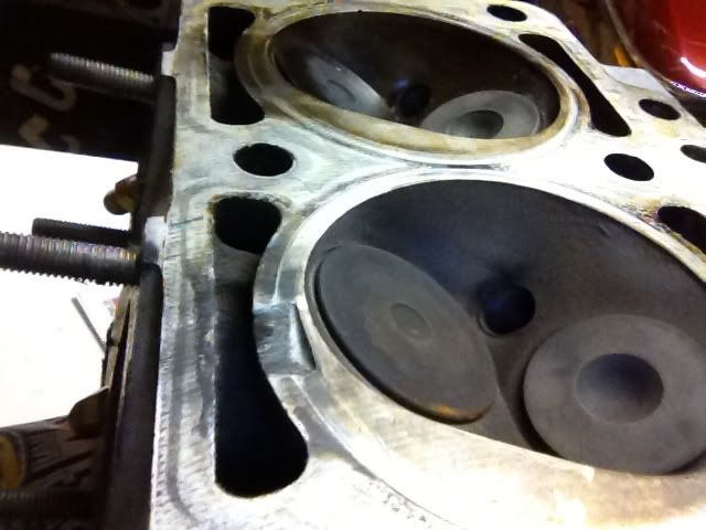

                            Fixed the valve train with rocker locks, titanium retainers and dual valve springs. Back at the 1/8, first hit did nothing but slip the clutch. After putting some heat in the clutch, I made a third hit of the year with the holset and did this to my number 3 combustion chamber...
                            So now I am back on the road witH the t3/t04 turbo I ran last year set at 18 psi. My wife will kill me if the thing breaks, lol.
