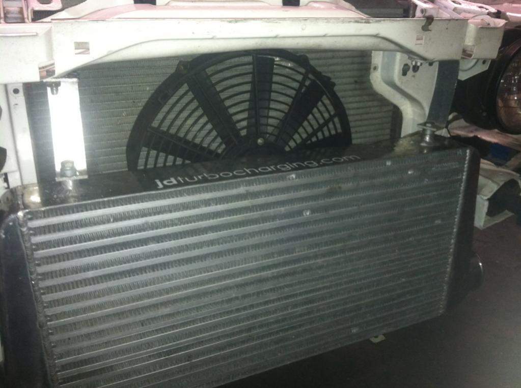

              Manifold is welded up, intercooler is mounted.

                  pics
                  E36 bottom mount ebay manifold modified for top mount and reinforced to shit with external wastegate provision.
                  Also got the intercooler in there really solid, would not hesitate to drive this with out the valance, which is gonna happen a few times obviously haha.

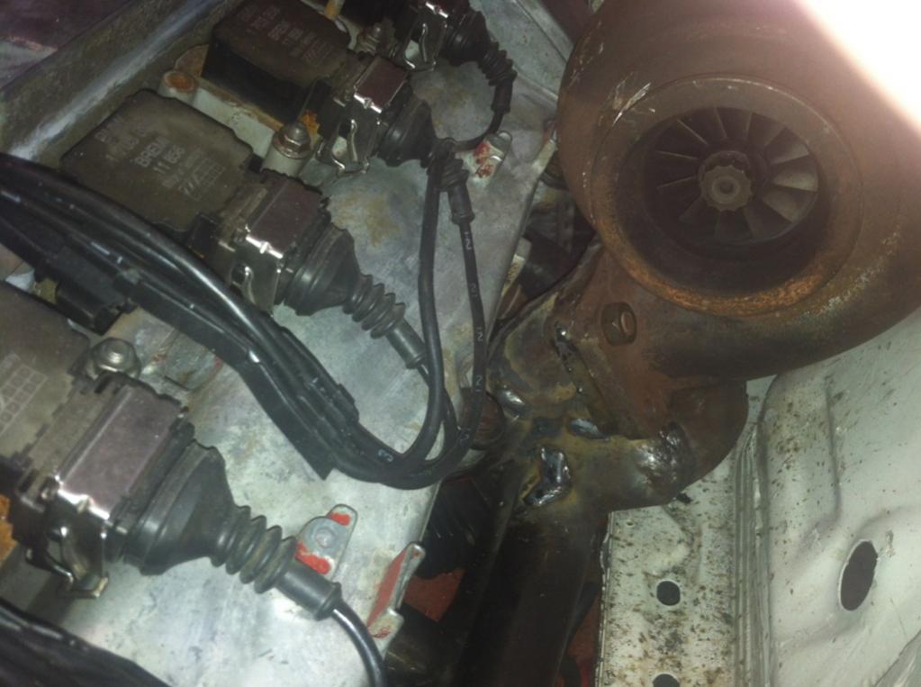

                                Tacked up the downpipe last night, my buddy tigged it all together today. Looks closer to the valve cover then it is. Still gonna build a heat shield.
