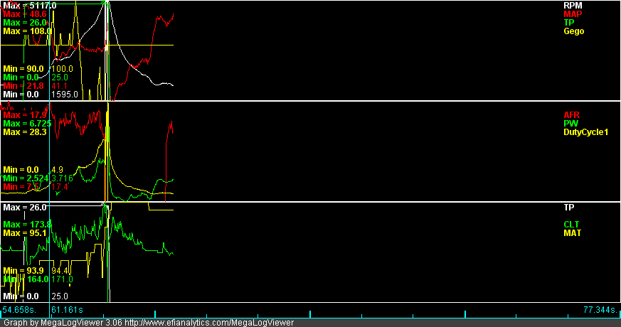

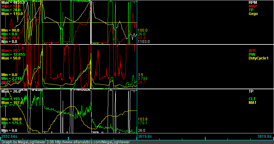

        heres a data log with a few pulls to the point where it starts to act up
        jaxx i know what you mean now, i just haven't figured out how to post it for you

          also my afr is the stock sensor so please ignore that haha

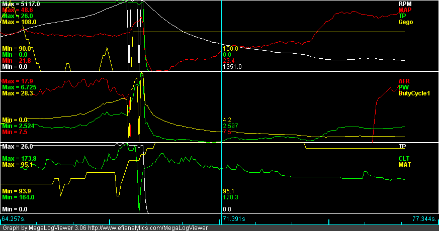

                this is the free rev log

                  can't see shit.
                  Increase resolution by pressing the up/down keys.

                      .Zip your log and msq, then attach them to your post. It could be anything.
                      Is throttle position really 26% or are you flooring it?

                        Its really 26%

                          How did the CPS check out?
                          FYI the 26% throttle position is a non variable cruise signal, with a stock TPS installed it gets a fixed 0, 25, 100% signal for idle, cruise and WOT from the stock TPS switches.
