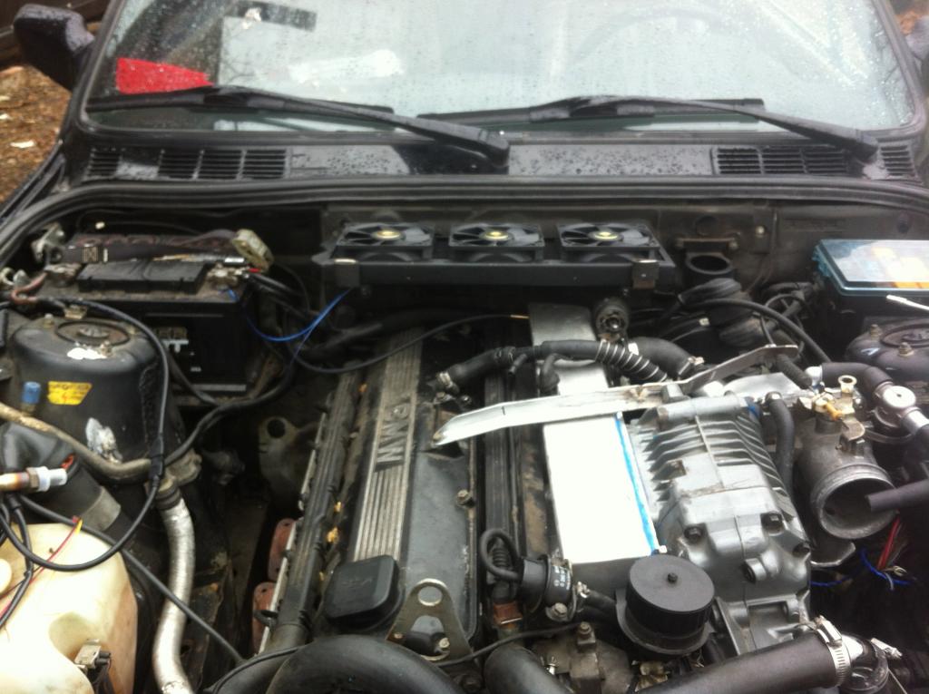

            This is the part where I post a teaser pic of the new pulley mounted.
            sexy m90 pulley
            It has been an odd year but progress goes like that sometimes.
            I plan on cramming an m90 down in there just above the stock alternator location. A tight squeeze for sure.
            Something like this but with even more crazy ghetto pipe snake situation.
            crazy pipe snake
            I think I will try to keep the boost pipe facing down, towards the engine, but the problem is the intake is now also facing the BACK of the car, so both will have to go under the unit so it doesnt look incredulously redic. I had the intercooler planned for the front driver high beam but I might try a different route due to pipe city- maybe top mount+scoop wrx style?
            Anything is possible/ what is our problem link: http://www.thetruthaboutcars.com/201...superchargers/
              crazy pipe snake
              [/URL]
              Whos setup is this? Any more pics of it?
              • Q5Quint
                • Jan 2005
                • 725
                #112
                I just found that pic with internet wizardry when looking at options before, not sure whos setup but it is a short nose m62 not a m90.
                You can tell he used a m50 pulley and got rid of his ac and ps pulley because the serpintine belt for the charger is back far enough to allow for the stock fan. This would be the correct budget method instead of custom pulley $$ + stock fan removal. I am old and wanted to keep the ps and ac as-is.

                  That snout does not mount to m90?
