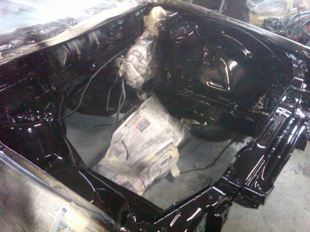

    Hey guys, the first time i posted u guys had a lot of jokes.but the car is comming together now
    hers a list what i have
    precision turbo t3 6262 dual ball bearing turbo
    tial 44 mm waste gate
    greddy blow off valve
    3 inch straight exhaust
    haltech e6x standalone with 3 bar map sensor
    metric blue head studs
    and factoryhead gasget
    .. Now for some pics.and first start and drive videos
