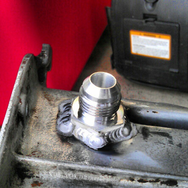

            Here's mine for preference (m20):
