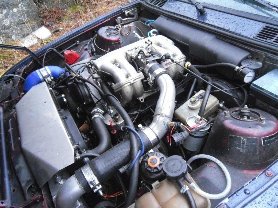

    Bmw 316T 298Whp/373Nm
    Hey. As the thread name, I thought posting the so-called " pioneer " of my project, an E30 with 1.6l turbo.
    It began as a spontaneous building, and to have something to drive in the summer of 2013.
    Here is a video from Track day on Eikås now in September. It was 1.6L VS E34 S62B50 with compressor.
    Engine:
    M40B16 pistons lathed to 6.8-7.0:1 in Comp.
    M50B25 Advise and Border Store
    M50 oil spray nozzles to the pistons.
    O-ringed block
    Top:
    Original 1.7mm Head gasket.
    B16 8v Head
    Ported
    Mi-Cam Around 272 degree duration with a convenie valve lift of approximately 13.0MM
    Lathed valves
    2.5 " throttle.
    M50 Tps
    B18 Intake
    640 cc injectors high resistance Simens.
    Single Reinforced M20 valve spring.
    Exhaust :
    Collector manifold 4-1 2-3 With split pulse
    3 " downpipe behind the rear axle that goes into the 2.5" with one "maze" muffler
    Chassis :
    Sachs 618 pressure plate with 228 organic cluth
    Getrag 260 Transsmition.
    Rewelded transsmition bracket with M20 flywheel
    M20 Drive Shaft
    E34 Motor Pillows
    Rewelded gear arm
    325 with 188 Rear Diff 25 % lock
    325 Front Brakes
    205/50-15 Street Slicks
    Electrical / Ignition / Motor :
    Rough adjusted along the road
    Vems V3.3 Motronic plug, soldered to the original wiring harness.
    Msd Blaster SS
    Msd Ignition Amplifier 6A
    Bosch Advantages and rotor
    Ngk-r Sparkplug
    Zeitronix Zt-2
    China oil pressure and oil temp gauge.
    OEM ignition cables
    Turbo :
    Mitsubishi Evo 9 turbo divided pulse
    2.5 Bars Evo wastgate actuator
    Div Miscellaneous
    Rewelded Biltema intercooler
    M20 radiator with 14" "Heavy duty" fan
    2.5" piping
    M20 Expansion Tank.
    Truck airfilter
    10mm fuel filter from Ebay.
    98 octane fuel
    Hand lathed oil filter cover for oilpressure and oil for the turbo.
    Attach brake paper was doing in August 2013.

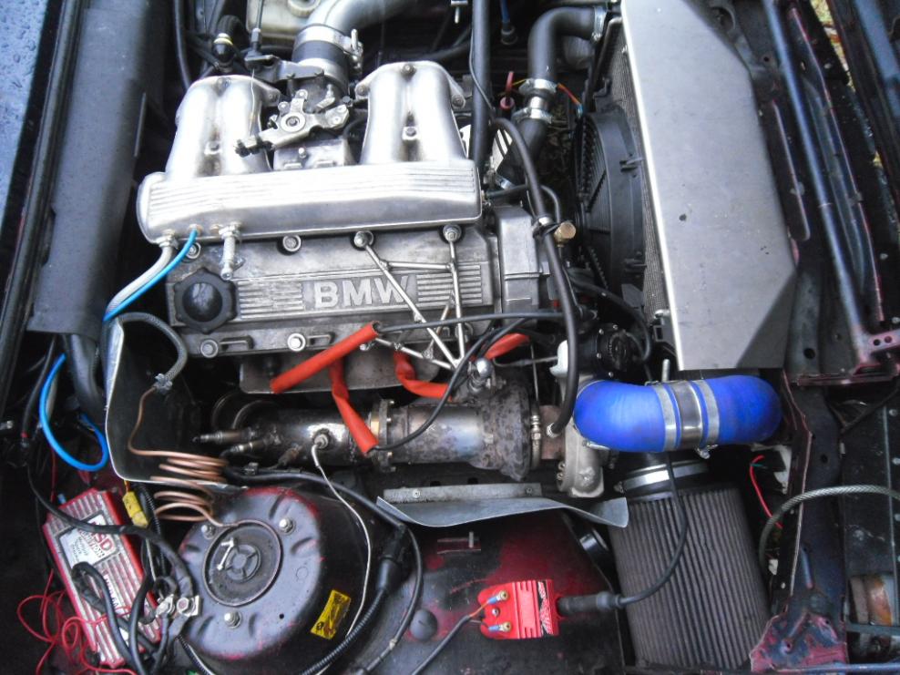

    Awesome, love the home made factor on this build. What's the copper coil coming out of the firewall for? Also it looks like you have four plugs into the down-pipe. I see narrow band O2, wideband O2, EGT but not sure what the fourth one is. Looks like a nice curve above 4000 RPM I be that baby hits hard!
    • Rc00047
      • Jan 2014
      • 4
      Thanks! The coppercoil where to measure backpressure in the exhaust. The fourth plug in the downpipe where also to measure backpressure, but the coppercoil braked and i needed a shorter one becouse of that. It's quite a push from a 1.6l :)

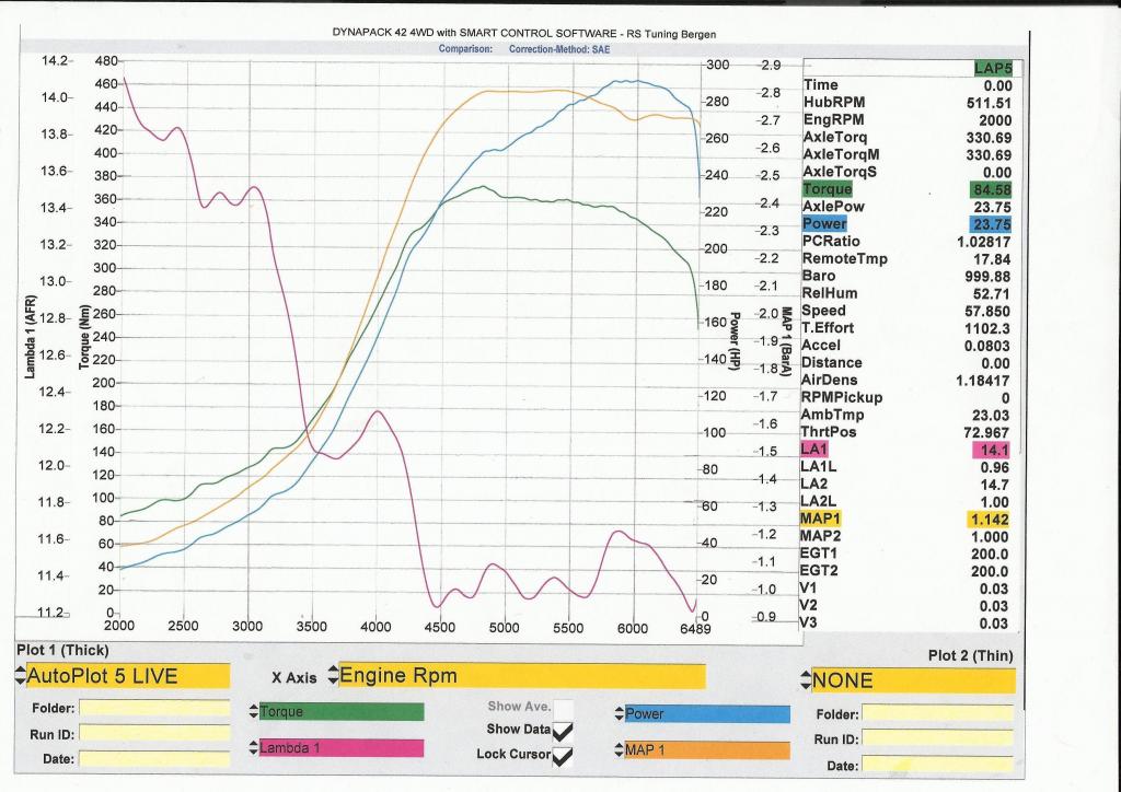

            • Rc00047
              • Jan 2014
              • 4
              Originally posted by wazzu70
              Very cool. I have considered an EVO turbo on my M42. Glad to see someone put it to use.
              Tusen Takk for sharing :)
              I think the EVO-Turbo will be to little for an M42 engine.
              • Nisse Järnet
                • Aug 2013
                • 1221
                A friend had a evo 8 turbo on his m42, made 240whp on regular gas. Small 2.5" dp may have restricted more power. Or the turbo, i dont know :) Car ran great!
                E30 325ix M50 turbo 7 spd DCT 4wd 840awhp @ 31 psi.
                E30 M50 6 spd 764whp @ 24psi.
                E30 M20 6 spd 675whp.
                • Rc00047
                  • Jan 2014
                  • 4
                  I see. But if you look closer you can see that past 4500 the torque line is falling dou to little evo turbo. Becouse It's only efficient on 1.8 bar, when it is pushed on 2.2-2.4bar It goes into surge and dropping. But still, you will have the hp becouse that countinues to rise. The dynopaper are when i used the fabric evo actuator and that was only made for 1.2 bar. It was tightened to over 2 bar and the spring were sloppy. The new actuator is a 2.5 spring and is mutch more agressive on the bottom than the old one :P
