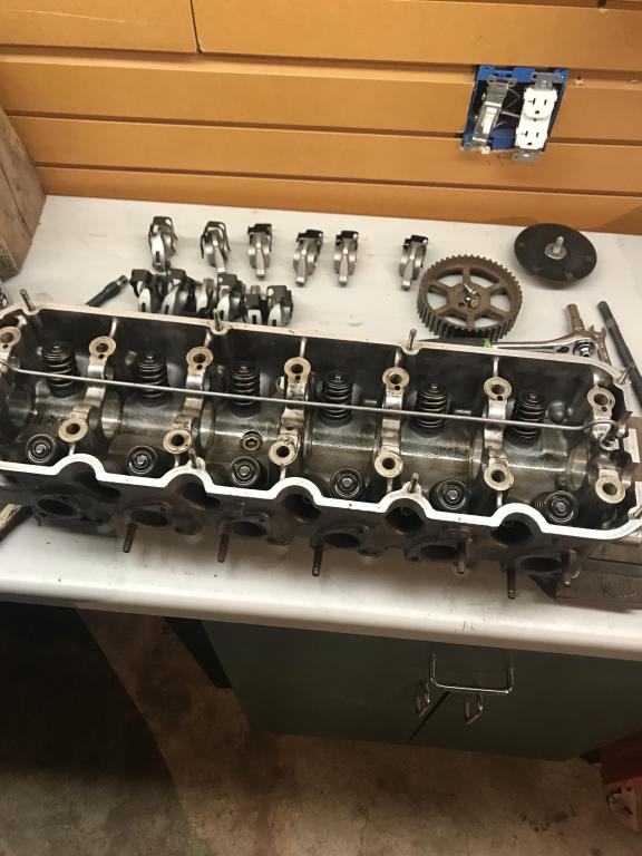

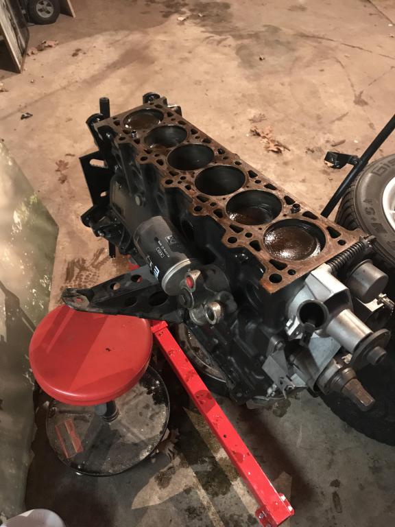

I was ordering an MLS head gasket today and they only had 85mm bore size. If I remember correctly the stock bore is 84mm. Is that an issue?
That being said, VAC only stocks the MLS 85mm x 0.120. My head has been machined so I wanted a taller HG while also lowering compression for the turbo. But from what i hear thick head gaskets can create new issues.
That's when the sales guy told me about the Cooper Ring - Cutting Ring Head Gasket -
These are only available in 85.5mm bore and 0.080" thickness. So this would bring me back to stock compression and be able to hold higher boost; however, the bore size is too big and I don't get the compression benefits.
What do you guys think about the gasket bore size difference and which, if either should I purchase?
I wana run crazy boost like 15 daily with the option of 20 down the road.
What do you guys think?
