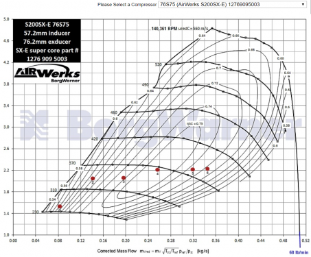

    Borg Warner Turbo S257 S200 SX-E
    P/N: 12769095003
    T3
    70mm turbine wheel, .83 a/r
    Compressor: 57.2mm inducer, 76.2mm exducer
    MatchBot reference: https://www.borgwarner.com/go/R4IF87
    Click image for larger version  Name:	5003_Compressor_Map.png Views:	0 Size:	182.1 KB ID:	9861665
    Going off the compressor maps, I'm leaning towards the S252 for better response and mid range. Note that I intentionally set the boost pressure to 17 psi from 5k rpm to 6.5k rpms to make sure I wasn't dangerously close to the choke line for either turbo.

      Another vote for the S257. I'd worry that you're getting pretty close to choke so your compressor efficiency is tanking pretty bad on the smaller wheel (8% points worse!). The larger wheel should result in lower pre-turbine pressure since you don't need as much power to drive the compressor and should generate more torque for a given boost level.
      The rotor group inertia is largely driven by the turbine wheel, so going up to a larger compressor with higher efficiency should more than compensate.

        The lower pre-turbine pressure is a good point, bringing the boost level back down to 15psi in matchbot it's pretty obvious that the engine delta pressure, or pre-turbine pressure is worse off with the S252. In the higher rpm range I would essentially be working the engine harder to achieve the same boost level vs. the S257. Considering I could theoretically build 7.5lbs of boost pressure at 2500rpms it should still be pretty damn responsive and the larger compressor would be better for future expandability if the engine is ever stroked or has the rpm limit raised.
        Thanks for the help!! I'm going to pull the trigger on the S257 :D
