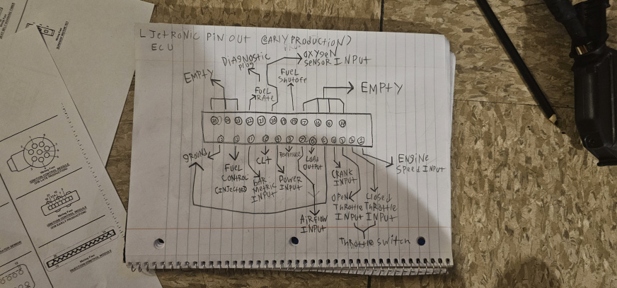

    L Jetronic ECU Pinout.
    This is a short and quick post in regards to my standalone conversion but since nobody seems to have this figured out yet or there's no infomation. Here's a quick sketch of what the ecu pins go on your ecu connector.
    Please be advised that this is for a early production wiring harness and your wiring harness may be different! Use this when you're trying to diagnose an issue with your electrical manual.

    Thanks for this!
    I'm guessing you've already seen these:
