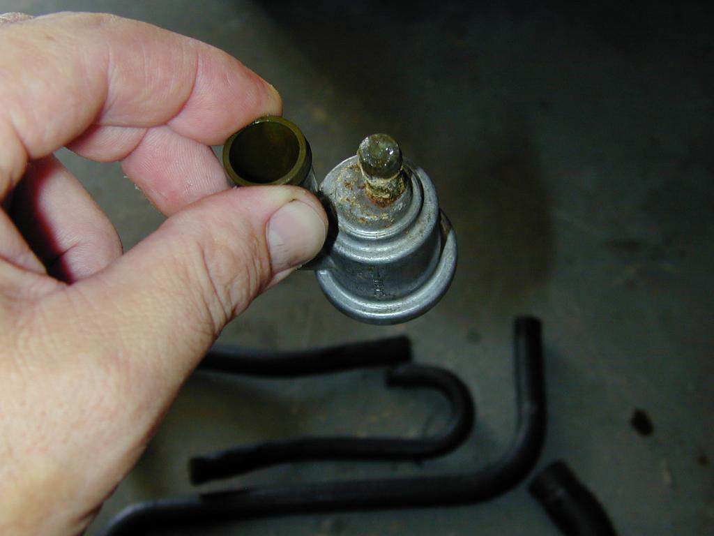

    also the above mentioned valve thingy is an additional thermostat according to realoem.com. what is its purpose if i also have the other thermostat near the radiator?? is this only for getting heat into the car before the larger thermostat has opened?? or???
    #1 in the pic is the additional thermostat, it is along the firewall above the bellhousing:

        this is an e30 recall item. It is a coolant by pass valve that when in "over heating" conditions, it stops coolant from going into the heater core thus reducing the chance of coolant burn if the heater core was to explode.
        this item is discontinued through bmw but you can find them on some vehicles. earlier models may not have them unless the owners took advantage of the free unit through bmw.
        I put one in my car bc my core blew up a few times on me and i dont like getting burned...a good thing to have id say

            Thanks guys. I think i may by-pass it as i seem to be getting random and odd water temp spikes. needle will hit 3/4 and no heat in the car. then minutes later returns to normal, so i wonder if that thing is sticking/clogged

              I tore into my '91 318is with an M42 this week to do the "mess under the intake" delete. I came across the "additional thermostat" which gave me some serious heartburn...I have deleted it...for now but I sure don't feel good about it as I don't want my heater core to explode and scald my lower half. Yikes. Anyone have a follow-up to this delete? See my video for further details.

                I think that was a recall to keep your legs from getting scalded.
                • Nürburgring
                  • Jan 2016
                  • 87
                  Correct. That's what I've learned also. I'm going to tempt fate and roll without it.
