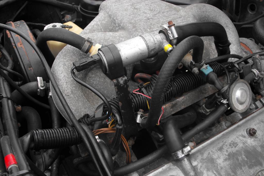

    Hey everyone, So I have an 84 318i that has not been running well. I took it to a shop to have the steering column replaced and the ignition switch replaced. After the shop had replaced it the car started running worse than it had been. and before that the car was not starting everytime like it would take a few tries before it would finally catch on and start up, and when it was running it would get warm and idle down to far and would shut off. Which is was it is currently doing now. And the mechanic who was looking at it said that the cold start valve was missing he thought, and he tried some different injectors because the ones it had were not right or the numbers weren't.
    I am not sure I was looking at other M10 motors for the 84 318i and I some had the idle control valve and some didn't and I don't have one of those on my car. although I haven't seen the car in a while so I forget what it looks like.
    If anyone has any idea's let me know.

      Take a pic of your motor so we can see if you have the ICV installed. First things first, replace all vacuum hoses and intake elbow to eliminate vacuum leaks.

            ok So an Update on my car I got it from the shop today I tried to drive it home but the car was running to rich and getting way to much fuel that I had to call AAA to get the car towed to my house. I got the car back to my house and tired it and it ran for a bit but still ran rich. I don't think its anything serious but something simple.
            also I do have an ICV on it. I am going to put pictures i took up in a little bit.

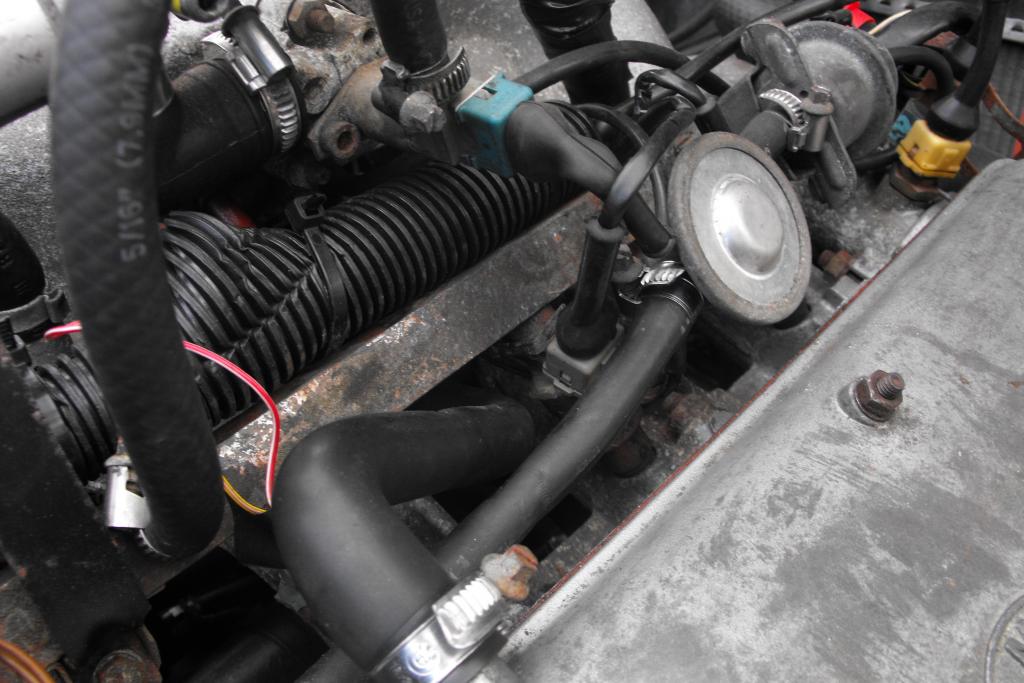

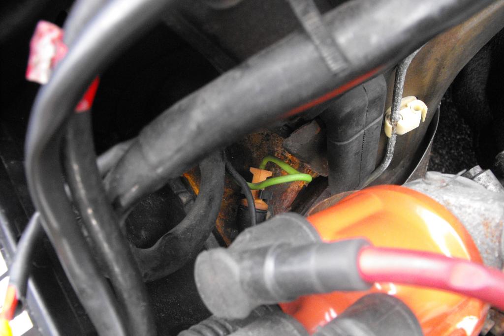

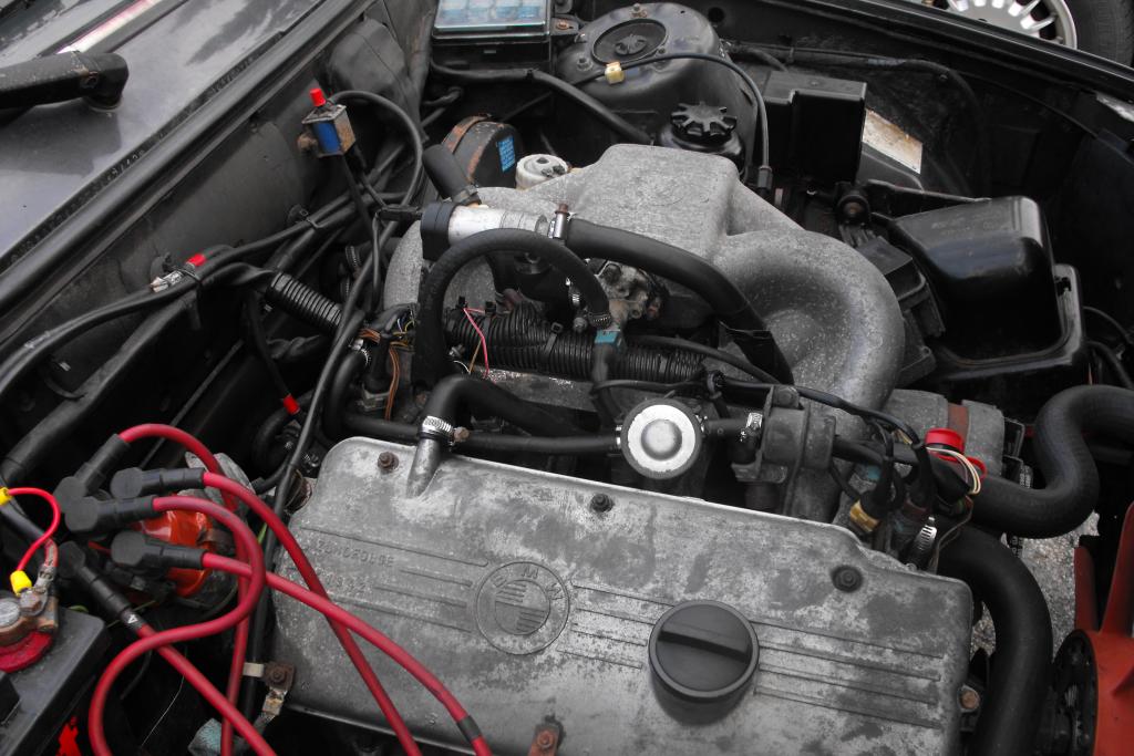

                ok so here a some photos I hope they go up. This is my 1st time uploading photos. But I thought everyone should see the madness that is my M10 motor. in a couple of the photos especially the one with the green wire and green and brown wire. Does anyone know what that is or what it might go too.(actually I put up the wrong pic I am gonna post the right one) oh the one of the single injector, the mechanic who worked on my car thought this one was putting out to much fuel and was causing the problems.

                    the green wire near battery should be o2 sensor wire...mine was there, and they use single wire o2 sensors.

                      Hey jean that green wire was actually near another set of wires on was Black and one was Green. they had some corroded terminals on them and one side was very badly frayed. Idk what they go to, Just wondering if you knew and if that goes to the O2 sensor.
                      I read a few sections in the Bentley manual and the o2 sensor was one of the things that I am going to check, As well as the cat.(pretty sure I have one)
