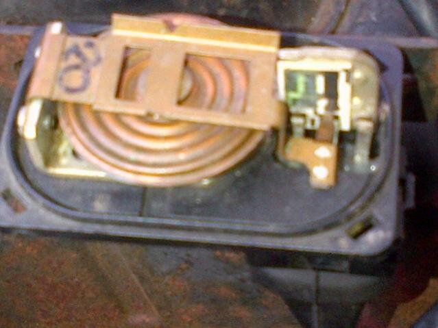

    Albuquerque ??....Check your altitude compensator !!
    Alice the Time Capsule
    • jeffnhiscars
      • Jun 2011
      • 6011
      The bellow is sealed so will expand at higher elevation which pushes up on the copper frame which has a contact (the tab above the 2 rivets to the right) that slides along a linear rheostat (the black stripe) that will lean out your mixture as the altitude increases (less fuel+less oxygen=balanced mixture).
      If your isnt working you are getting sea level fuel quantities with mile high air

        ok so when i tap on the altitude compensator it changes the idle a bit. is there any way to actually test it?
          another note..the fuel pump was changed cuz i got it for free. but the fuel injectors are spraying out a straight stream and that was trying on two set of injectors..
          and also when i pull the wire from the injector nothing happens i can do it to 2 and still nothing.. what can be causeing this? can it be the small computer module in the glovebox?? any help is greatly appreciated I ABOUT TO START THIS THING ON FIRE!!!
          The injectors should "mist" and if disconnecting an injector (or 2) does nothing than it is certainly malfunctioning so you need to replace them ASAP.
          As for testing the altitude compensator check Bentley or search. Moving it will effect your idle so that doesnt mean its not doing its job. Maybe your bellow is ruptured (sounds painful I know) so it still thinks its at sea level or the metal frame is bent (mine was after I snagged my sleeve on it).
          First swap out those injectors and let us know.

            i switch out the injectors and it still does the same the cylinder doesnt die out..
            the bellow??? so if like i move the altitude compensator or tap it and it changes it isnt working properly??
              If you can disconnect an injector with a running engine and nothing changes, you have a dead cylinder. If there is fuel and spark check your compression or could be an electrical connection regarding your injectors.
              No. It may not be adjusted right but if moving it makes a change then its working.
