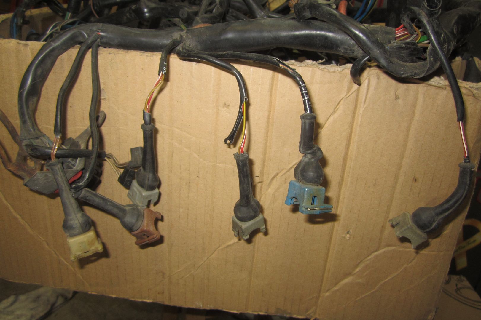

    I need a picture of the correct injector harness routing. Which connectors go to which injectors????
    Who has a pic???

    IDK if this will help, but here's a quick pic I took of the injector section of my spare M10 harness. All of the injector plugs appear to have the same color wires (red/wht and brn/yel) at a glance. If you have them all loose, not exactly sure how to tell..

      darn. yea the same issue im having. haha i think i got it figured out now tho. thanks irish.

        They should come out of the harness in order, if there really is one. The wiring diagram shows all four injectors sharing the same splice for power and ground. I'm pretty sure that's how the system is supposed to work, it's called batch fire and all the injectors open at the same time.
