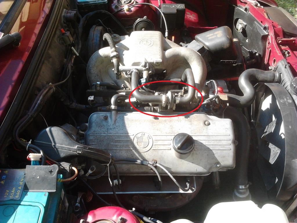

                  @TobyB : I have no such thing , instead I have this sucker , ICV(see pic).
                  It gets 12v like it should , It clicks at ignition like it should and I've tired 2 of these and it's the same.
                  I've checked for air leaks while the intake was out of the car.I checked every hose(vacuum and fuel) and replaced those that needed it.

                    Oh, hey, yeah, look at that- the fully- mechanical thermotimer warmup wonder.
                    Ironically, supposed to work better than the electronic gismo, that didn't, really.
                    I read something about those once- I seem to remember that they're adjustable.
                    You can look through it cold, and it should be somewhat open. Then, after you apply
                    power, it should slowly close on its own. Inside, there is SUPPOSED to be a little nut
                    (of course, they say, don't Fuch with Dat in the manual) that lets you adjust it.
                    We were going to L-Jet Jenn's 2002, so I found one in the junkyard and played with it
                    a bit.
                    The one I got was all gummed up, but worked pretty well once I cleaned it out.
                    Now I REALLY am not much help, eh?
                    t

                        nah, not for him- his is like an old electric auto choke!
