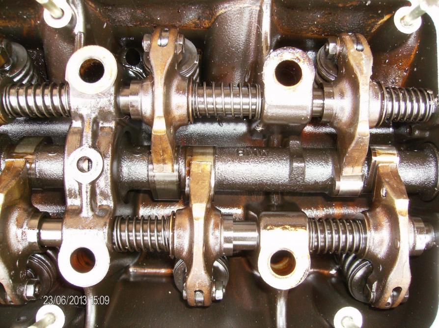

      nope, I have that tool. it compresses the rockers all at the same time so the cam can be removed. Unless I'm missing something and can disassemble the rockers and not actually have to take the cam out?
      • Tzzantaru
        • Jul 2013
        • 21
        Well you can disassemble the rockers w/o taking the camshaft out but you will have to take the rocker shafts out.
        You need to take the rockers 1 by 1 and move them to the left/right(in the direction of the spring) and take out the safety clip that's keeping them over the valves.
        Next you'll have to push the rocker shafts out of the head.You'll need a hammer and something cylindrical so you can keep hammering the shaft out
        Make sure to mark the position of the shaft relative to the head and the order(cuz the one on the right has a hole for the oil pressure sensor).
        Next , be sure to taka a picture or memorize the place of the springs and rings for the rockers.
        If you need I can take some pictures.
                and to do that, you'll have to take the head bolts out.
                Because on the M10, it has notches cut into the rocker shafts to clear the head bolts.
                Thus, most operations on the M10 start with
                "step 1- remove head."
                t
                • Tzzantaru
                  • Jul 2013
                  • 21
                  Nope , they don't.The head bolts go through just by the sides of the rocker shafts
                  But yes , you have to take the head out in order to remove the rocker shafts.
                  You'll have to remove the distributor case in order to hammer the shafts out to the front of the head and I can't imagine a way to do that with the head still on.
                  I assumed he had pulled out the head , if that's not the case , well , my bad :D
