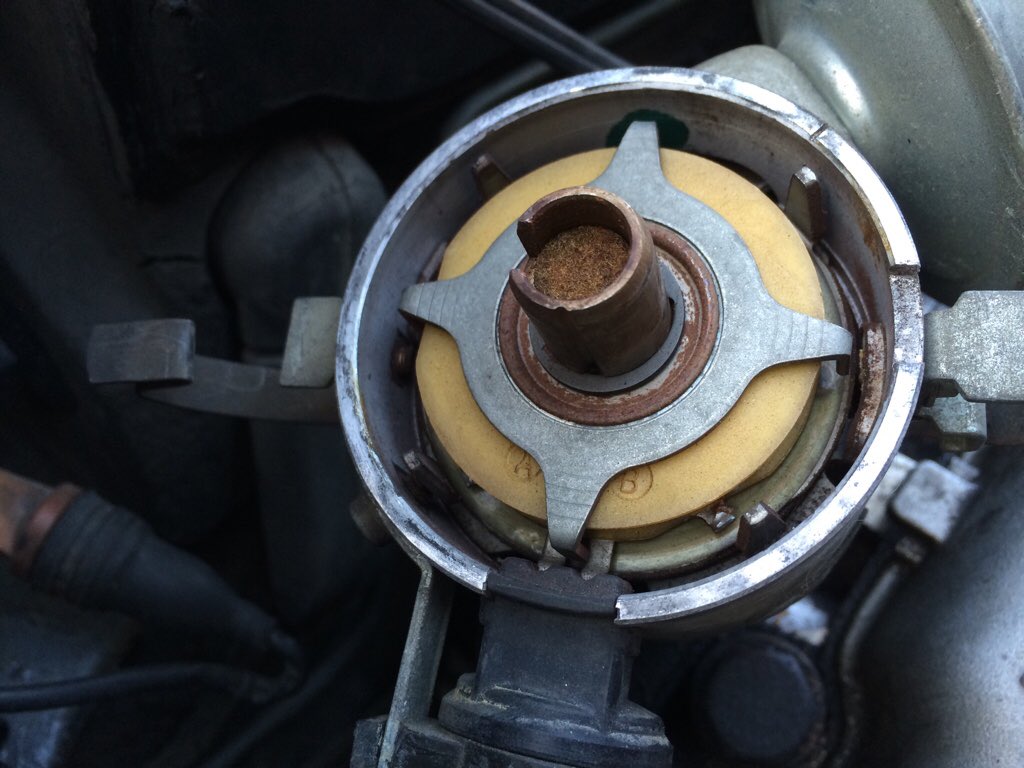

    Here's the distributed cap, see how the teeth aren't touching? Where are they supposed to be with the car off?

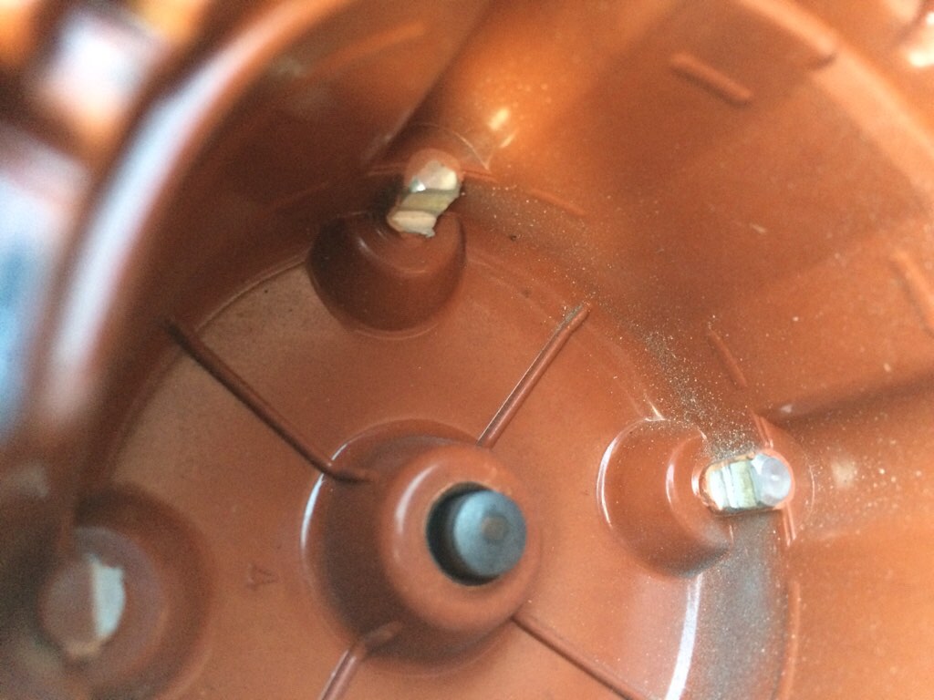

    Here's some metal shavings inside the cap. Maybe it made contact?

          The teeth should not touch. The Bentley manual gives a spec for the gap between them.
          The plug you're looking at is the RPM sensor. M10's use this rather than a Crank Position Sensor.
          Get/keep timing in spec and then address the idle issue separately by dealing with the idle control system. There's a large amount of threads on this forum for idle issues for you to reference. The Bentley manual gives more numbers than just idle for timing in case you want to further check your distributor.

            When I had it apart I cranked the engine to see what it all did. My mental picture of what happens was totally backwards, I thought they met and touched or something but one is stationary + vacuum advance and the other is directly on the rotor off the camshaft.

                I think you need a new distributor. That sort of cap damage, if the cap's seating firmly,
                usually means that the bushings in the dizzy are very warm.
                And yes, your vac advance is shot.
                t
