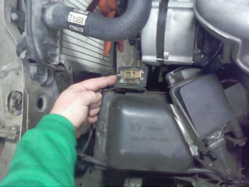

Anyone know what this is? Part on intake box...
  • SpyHunter
    • 318
    Don't have Bentley, needing assistance. Anyone know what this is? The sensor I am pointing to.
    Thanks in advance!

    That's attached to the airbox? I don't remember mine having that.

      its an altimeter. adjusts something for altitude, fuel air... whatever. not needed and can be left disconnected.

        Hmm. K. Was wondering if it was causing my issues. Fairly sure my car is running to rich part of the time.
        Reasons why I think this:
        1. Car starts up in the cold right away. Barely needs to turn over.
        2. Car drives fine while cold, or fully warm. But inbetween, if at anything below 4/5ths/full throttle, will chug and want to stall out. Let off gas and coast, it is fine as well. This will go on, until the engine is closer to operating temps. Then it is fine.
        3. Starting car in warmer temps, engine cranks and cranks, then finally fires. Probably a 3-4 secs worth of cranking.
        4. Pulling out of inclosed parking spot, and that area will smell of fuel.
        Still not sure what to think.

          check the temp switch, on the front of the motor. cold start valve, and ICV
