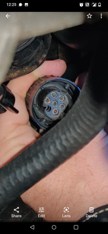

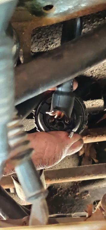

                        e30austin , so I went out and checked the C191 plug again, and upon closer inspection, it looks like one of the female points is no longer there? Definitely looks strange. Not sure if that's normal or not.
                        Also, to answer your questions: I held the fuel supply line and return line in my hands with rags over the end to make sure one of them was getting fuel. I couldn't remember which one was which, and that felt like the clearest way to tell. I put that one on the rail.

                          Female connection look super corroded need to sand it and clean it. I cleaned mine with a wire brush carefully. About fuel lines the upper one is the return line.

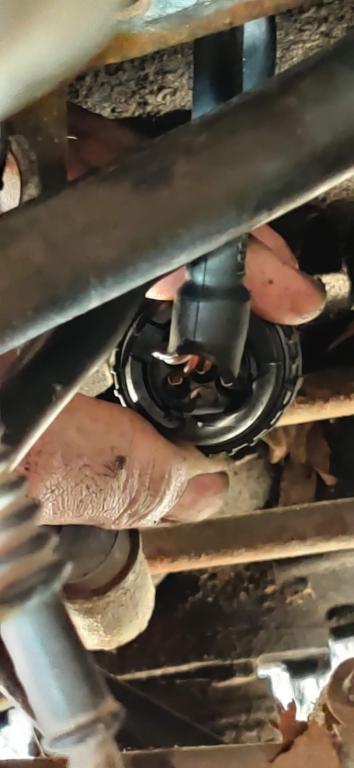

                            So, on a hunch I opened the boot of the female connector to see about that missing connector...and there's nothing there. There's literally no wire that connects to that. Back to having no idea what's going on.

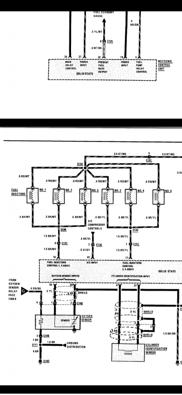

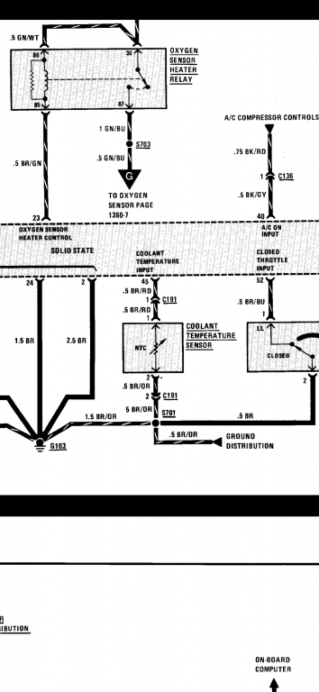

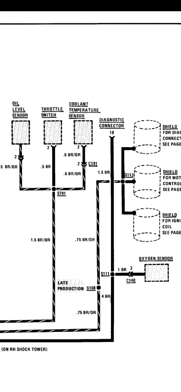

                              Click image for larger version  Name:	Screenshot_20210530-172753.png Views:	0 Size:	129.1 KB ID:	10019728It is a good time to just remove it completely and do this https://m.youtube.com/watch?v=I3_ad7Et2QM
                              Good luck
                              Attached wiring diagram for color codes for the wires c191 has injectors, temp sender and temp sensor wires.
