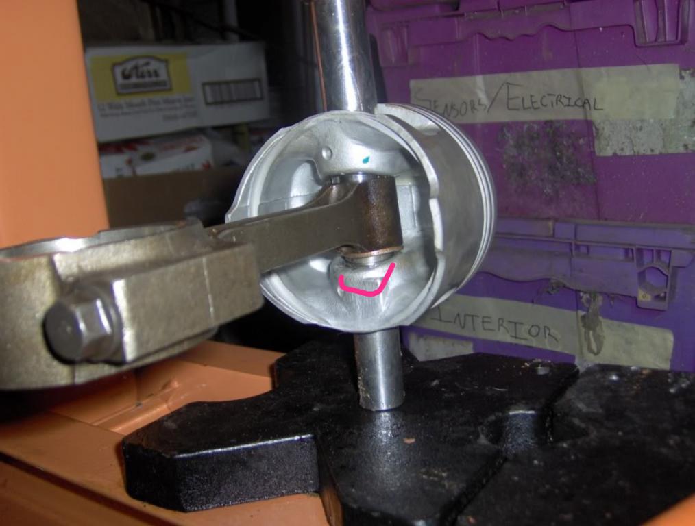

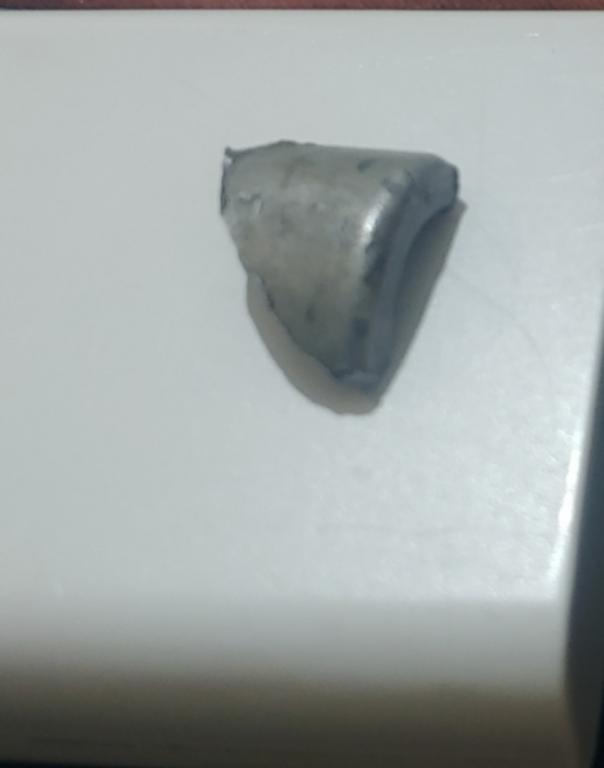

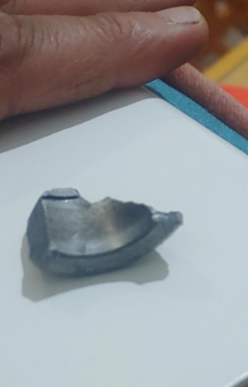

    Other stuff were within specs as per my mechanic i started it fine and do 50km braking in and then the drama starts with knocking noise at 2k my mechanic said it is my camshaft i got a clean complete head noise still there, I googled and i suspect a spun bearing popped the oil pan and all rod bearings are fine then i found this after guessing from where it came i looked up and found my #1 piston is missing this piece couldn't take a pic but i highlighted from a google picture .....
    Why the pin housing got cracked like this??? Click image for larger version

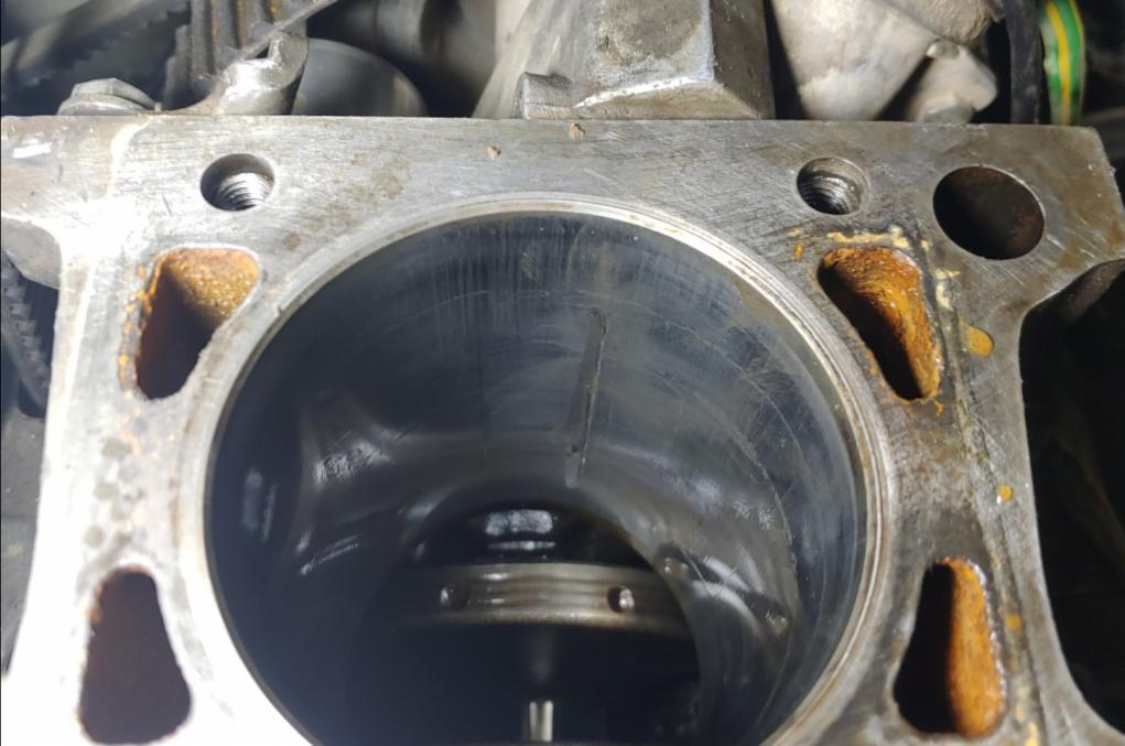

    After pulling the head and got the piston out it i found out that the piston wrisrt pin got out although the circlip still installed and badly scored the new sleeved cylinder bore
    Stupid mechanic. Click image for larger version

      How did wrist pin shift if circlips are in place?
      • ADEN
        • 620
        I managed to get the pin out and in while the clip installed maybe the mechanic shouldn't have reused it or at least test it before putting it in.
        I have read the same thing had happened to hondas and gms guys.
        Maybe i'm just having a bad luck
