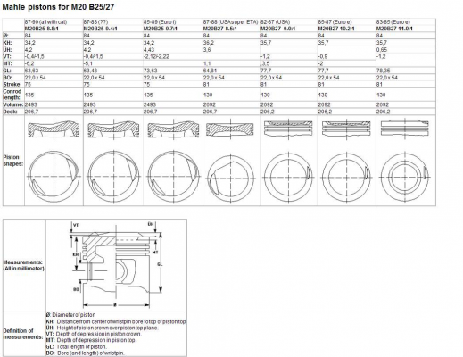

        I pulled this pic form the forums
        • jbontke
          • Mar 2019
          • 449
          The pistons have different profiles on the top, each for a different cyl head. Your m50 pistons are not on there, but hopefully the image above will help some. What may not help is if the piston profiles are vastly different from the cyl head. You may get strange cyl fill and compression that could cause pre ignition or incomplete combustion. That may be more noticeable at full throttle.

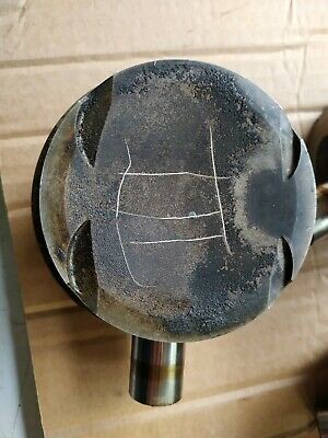

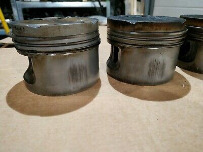

              The m50b25 early pistons 10:0 CR according to https://www.e30zone.net/e30wiki/index.php/M5x.
              These pistons have a very light dish that i estimated .5 in my calculations they are the same as the ones in the pictures.
                Mine are M50 10:1 CR and they are almost flat pistons as the 731 needs flat piston i think i am good on this issue .
