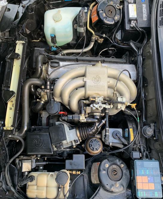

    Hi,
    new to me 1989 325i convertible with 131.000km
    this has been the case (and maybe not a problem) since I got a month ago.
    cars starts fine runs fine has power but when I blip the gas it kind of chokes like a sort of delay. If I push the gas slowly not issue at all.
    has new oil and filter plugs air filter and the car is extremely well maintained.
    Is this normal and if not what can I look for in sorting it out?
    in my opinion this is not right as I’ve had tons fo cars and none had this type of choke\delay when I blip the gas.
    thank you

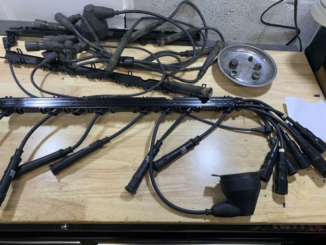

        putting new wires today.
        plugs are new and made no difference
        bee fuel filter also

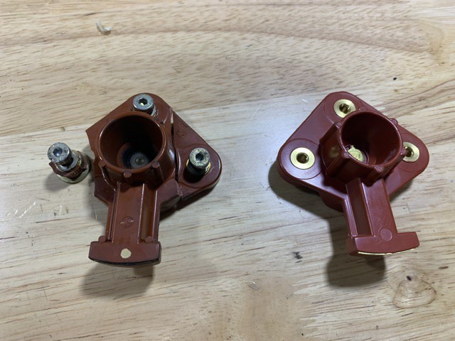

        will check the rotor I have new

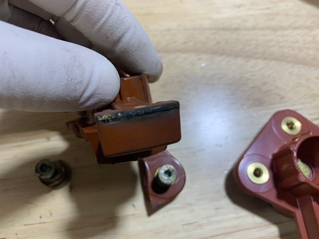

          I removed the distributor rotor in pieces as I couldn’t get one bolt out and it’s obvious this was not making good contact.

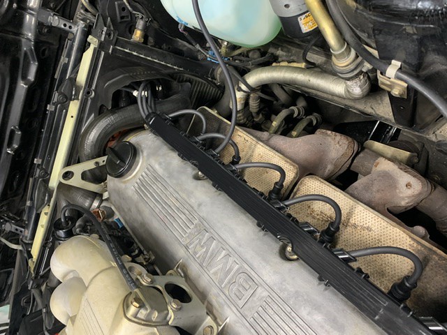

          I have installed new rotor cleaned the cap abs new bremi cables.
          Car starts and runs excellent with no hesitation.
          I think this did it.
