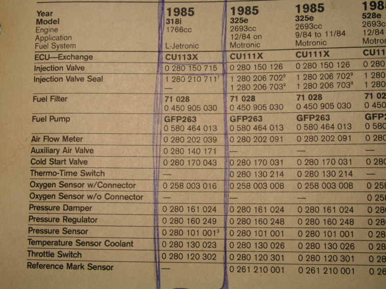

    Th Click image for larger version
ID:	10086705 is might help from a 1992 Bosch catalog

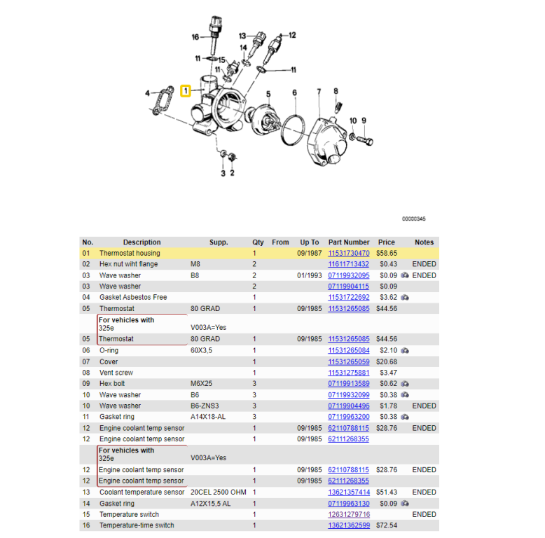

            Okay, so just to clarify again, you're telling me to bypass sensor 13 on this diagram?
            • e30austin
              • 15382
              no. 15
              • hurryupcole
                • Nov 2022
                • 17
                Originally posted by e30austin
                no. 15
                Okay, 15 has been replaced with a new 45 degree temp switch and is working properly. A company makes these new I forget where they're located but here https://blackstarmanufacture.com/pro...t-temp-switch/
