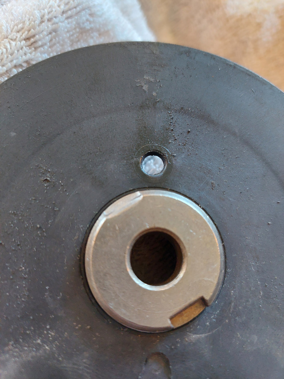

        Thank you. I just spent like 2 weeks fiddling. You saved me from more despair. Rotor was def on backwards. You can see the indentation on the pic. I feel kinda dumb lol.
