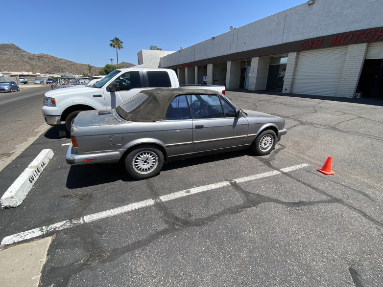

    1988 E30 M20 Stalls
    First post on this forum. Forgive me if I go too far. Some background. I don't actually own this car. It belongs to a widow. She and her husband are (were) long time friends, and he passed in 2020. I used to see him in this car and my memory of him is kind of tied to it. Which is a round about way of saying that this is a bit of labor of love.
    I am a car guy and have worked on a lot of different models, but this is my first time working on an E30. This car sat for over 7 years. When I went to collect it, it was filthy, having sat outside unloved. It also had mold inside (convertible tops never seal perfectly). I got a ozone machine and killed and cleaned out the mold before taking it further. Since getting it, I have replaced the timing belt, water pump, t-stat and housing, hoses, radiator, fuel pump and filter, injectors, tires and likely other things I cannot remember. After a lot of work I was able to get it to start, and while bleeding the coolant it ran and idled fine. I didn't really drive it after that except in and out of the shop. A couple weeks later, I decided to take it around the block. It seemed to run fine at first. I took it fairly easy but did run it up to probably 3000 rpm. I only drove it around the neighborhood at speeds under 50mph. Total trip was less than a mile. While it ran great at first, when I stopped at a stop sign it died. Since then, it won't idle and I have to fuss to keep the engine up over 2500rpm just to keep it running at all.
    It also is hard to start.
    Right now I am dropping the tank. Going to have it cleaned and inspected. I got a new fuel filter on the off chance that it is sucking up crud from the tank and blocking the filter. Leaving that aside, are there any other things I need to consider as part of my hunt for a diagnosis and repair? Thanks.
