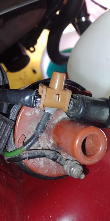

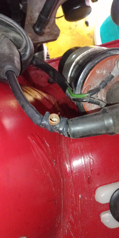

        The previous owner had an eye for detail and left me, for example, a cable connected to the coil at a clamp. It worked for quite a long time before a few wires broke off. ..
