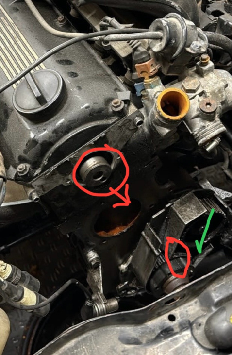

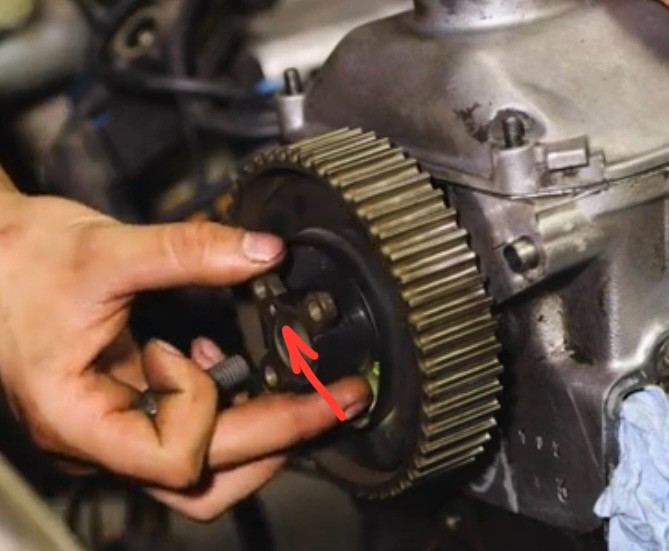

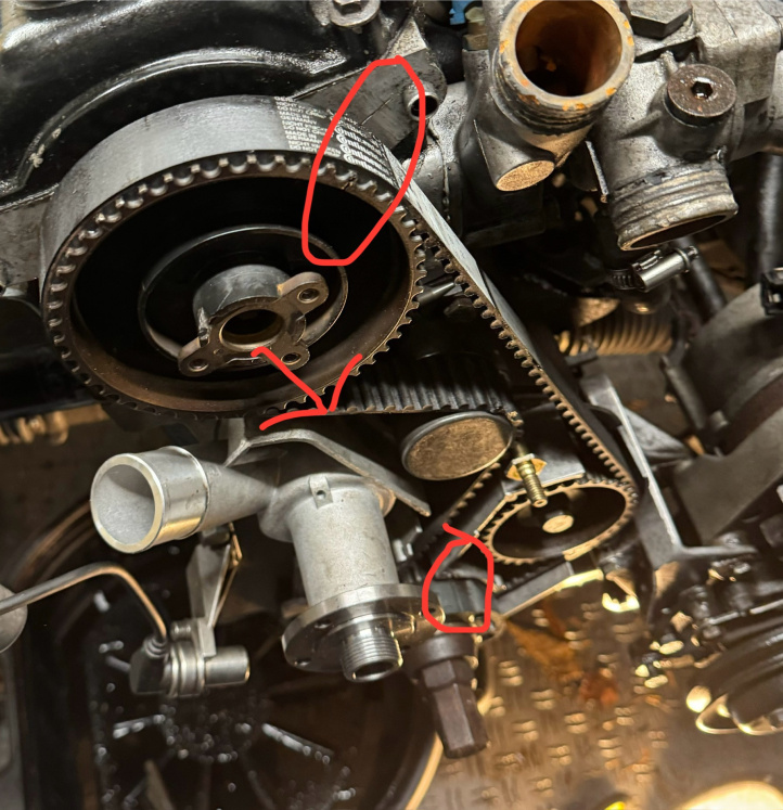

    When double (like quadruple at this point) checking my timing marks, I used a screwdriver to also verify C1 was at top dead center, even after cranking it a few times. It all was right, TDC with the timing marks both aligned. I did notice however, that my rotor mount was facing 180 degrees from every manual and video I saw. First photo is an example of someone else’s, 2nd is mine. 3rd shows how the cam has an alignment hole, which prevents me from mounting the sprocket, and rotor up any other way.
    I noticed that the rotor is set to strike c6 when aligned at TDC, so, I swapped my 1/6, 2/5, and 3/4 wires going into my distributor cap, and boom the engine fired right up, sounds and runs just as it did before when I first got it.
    I have talked to a few buddies locally, and one who's friend had done 25+ M20 timing belts and never seen this. Does anyone know what’s going on? I have no history on the motor, no clue what previous owners may have done. All I know is that it still seems to run strong. Am I at risk of anything?

    you probably installed the little adapter piece that holds the rotor button incorrect (180 degrees out) or the camgear pin is missing. it is indexed but ive seen people screw it up before especially non mechanically minded.
    if you have an aftermarket cam the hole could have been drilled 180 out but this is not the most likely culprit
    your timing marks look out by about a tooth as well accounting for parallax error

      Old photos, timing is fine after I did it the 3rd time... It runs great. I’m just curious what the deal is with it being 180 off.
      The adapter/rotor all is installed the only way it will fit actually. It was this exact same way before I even touched it; so sounds like the previous owner drilled the cam alignment hole on the wrong side. That’s the only thing that makes any sense, because without modifying or breaking tabs on the rotor holder it won’t go another way.

        the middle prong on the adapter is clearly pointing the wrong way so it’s on backwards relative to the cam gear. What was modified by the PO to get it to work that way I don’t know. I wouldn’t be perpetuating mistakes if I was you if not just for the next person who has to deal with it
        were the wires flipped originally before you started the job ?

          digger yeah the wires were swapped before I started the job. Thankfully I took some videos, and had taped/labeled each wire (because I thankfully didn’t realize the wires had numbers printed on them already). That’s how I was able to finally understand what was going on and start it again.
