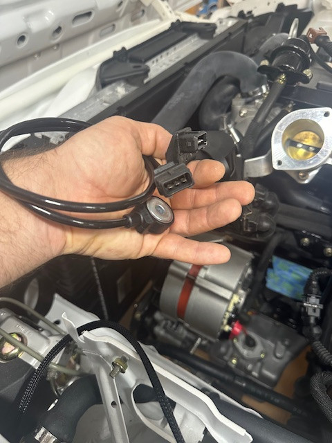

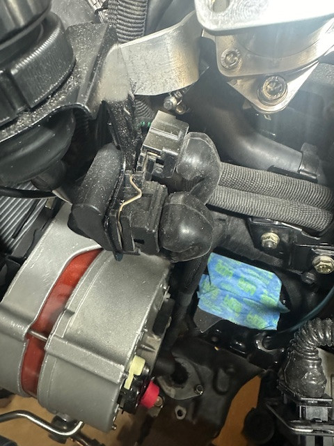

    Just in case anyone want a knock sensor and needs to wire it on M20 harness, you don't need any wiring. One can use already shielded CID sensor plug.
    I'm going from MS@ to Haltech for its superior Alpha-N running. Haltech has plenty of inputs (more than I need for this M20) so I decided to install a knock sensor.
    If you get a sensor with the wiring lead (3rd pin is a shield wire), it plugs perfectly into CID plug with goes all the way back to ECU plug as shielded cable.
    Hope someone finds it useful.

    also to add. The re is placed on the block, right in front of the starter where one can mount the sensor, just need 10x1.5 to 8x1.25 insert as the hoke is bigger than the hole in the Bosch sensor.
    M20 probably has no need for the knock sensor but my 2.9 is 10:1 so why not
