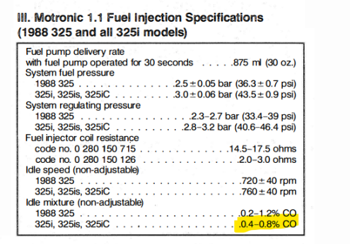

    Is this the correct Fuel Analyzer tool to properly tweak the AFM screw?

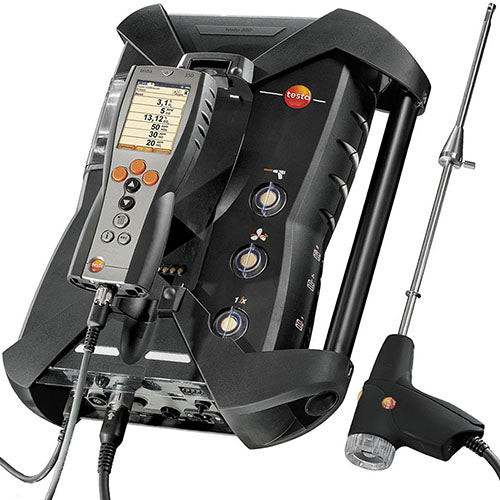

    I know people mention you cannot touch that screw without a fuel analyzer, is the below link the proper fuel analyzer to use?
    Rent the Testo 350 Engine Kit for combustion compliance testing. Measures O2, CO, NO, NO2, SO2, temperature, draft, flow, and hydrocarbons. Rent from RAECO Rents.
    I ask, as per Bentley (screenshot below) the CO range should be between 0.4% - 0.8%, while the Testo 350 fuel analyzer tool I provided the link to will show a "CO range" of "0 - 10000 PPM" and not a percentage range like Bentley shows. The "02 range" for the tool however does show a percentage range of 0 - 25%
    Click image for larger version  Name:	image.png Views:	0 Size:	151.8 KB ID:	10133990​

      I did a Google search on the Gunson and a lot of people are concerned on its accuracy as its only accurate to 0.5%
      Will the Testo 350 that I shared work for the e30?

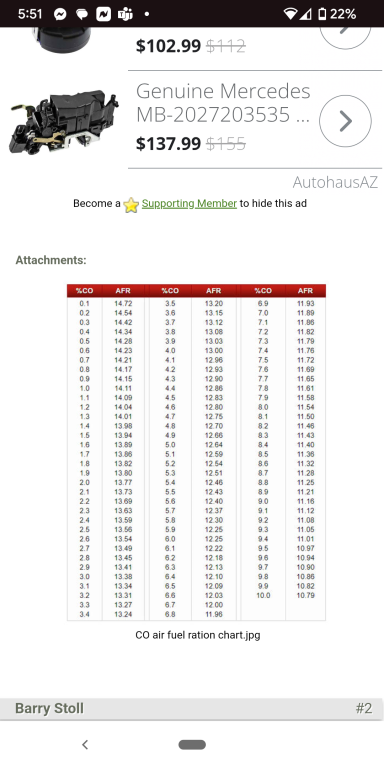

          I just got the following:
          https://www.amazon.com/dp/B001S7W836...fed_asin_title
          With that, I located the attached screenshot (AFR to CO% conversion chart).
          With the Innovate LM2 that reads AFR, and using the CO% conversion, would I then properly be able to adjust my AFM screw to produce the correct CO% per Bentley?
          • TobyB
            • Oct 2011
            • 5288
            yep, that'd do it!
