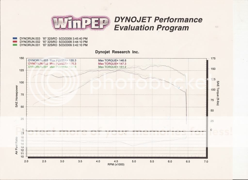

    Yesterday there was a dyno day at one of the local tuner shops. Three years ago I did a budget stroker build. When I was planning the build I couldnt really find any dyno runs with this setup so I was curious what kind of power it would make. The motor is rebuilt and and has about 3k on it. My brother also dynoed his 09 335i with a vishnu procede ecu piggyback . Anyways our results were a little lower than we expected. We were really close to sea level and it was about 75 outside. At the end of the day the owner said that everbody's readings were a little low so he thinks the dyno needs to be relcalibrated. So let me know what you think Low or not?
    Setup is
    -super eta maxil 84.5 mm pistons
    -eta crank and rods
    -I head with top end performance 272 cam
    -I engine managment, fuel injection, throttle body, intake manifold
    -Bav auto ignition wires
    -Jacobs ignition coil
  • nando
    • 34847
    not really, it's a low comp engine with a mild cam and no tuning to speak of. just look how lean it's running. You may want to check to see if your TPS is working (it might not be going into the WOT map). otherwise, if you did some tuning it would make a good 10whp difference.
    Another thought is your engine is decently suited to a turbo, all you'd really need to add are some ARP studs.

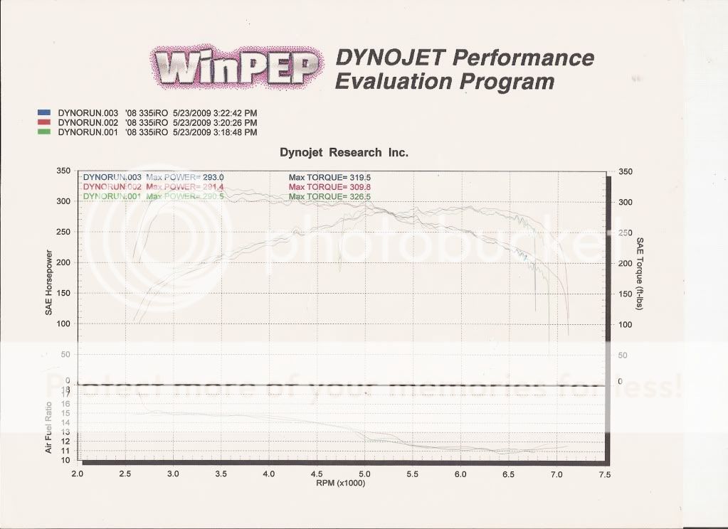

              My brother's car is the second chart. He put down 293. Ya I cant wait for that :)
