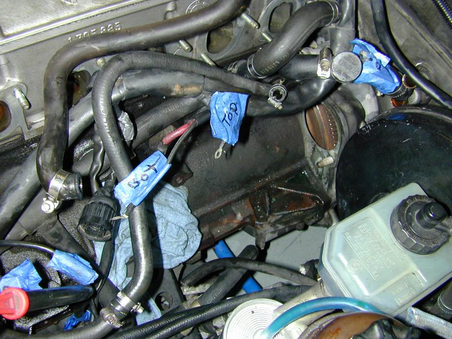

      the green/black wire that goes to the top post on the starter? It's connected.

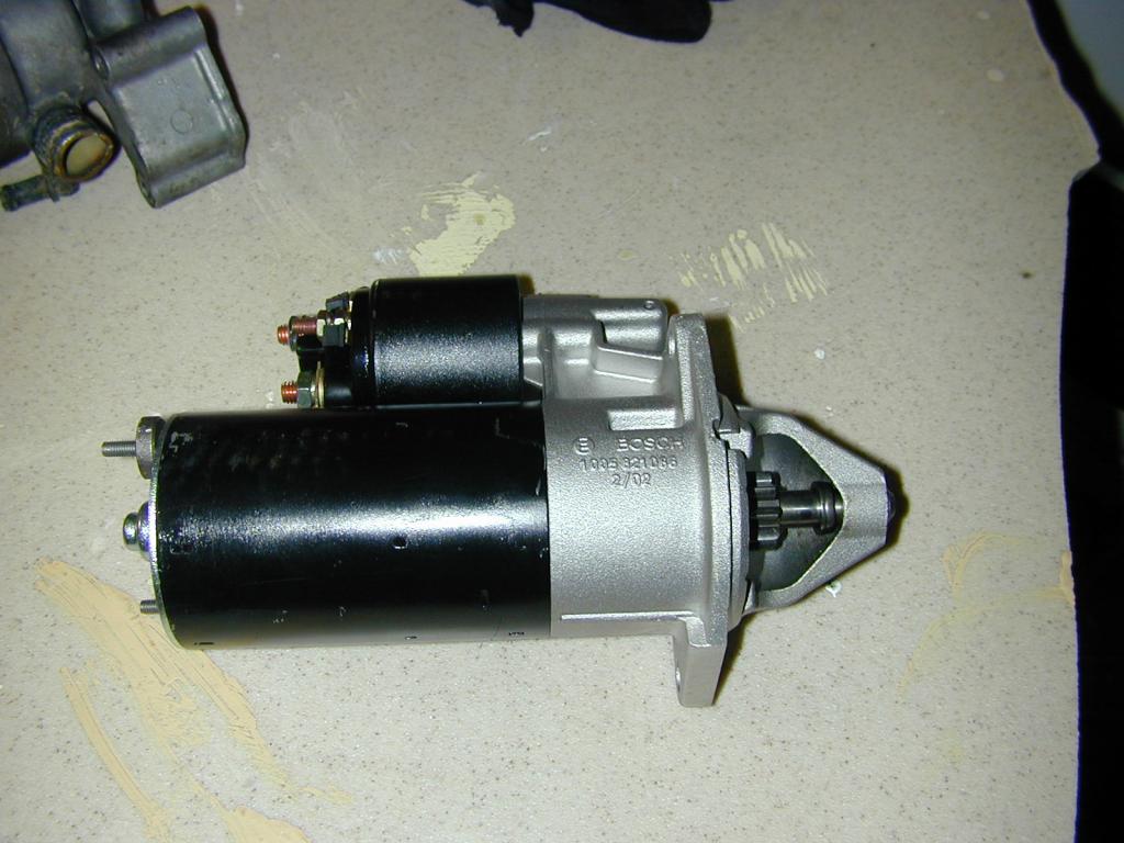

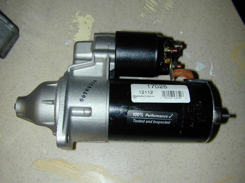

          I can't tell from the picture, but does that starter have two small lugs and one large lug? If it doesn't have small lugs for the start and unloader connections, you have the wrong starter for this car. Which would explain your problems.

              I removed the starter and took it with me when I bought the new one. Identical.
              It has the gr/blk connected to the post at 12 oclock, the 2 hot leads at 3 oclock and
              the black wire at 6 oclock
              the 2 small wires only fit on those posts they are on, different diameter holes.
              dummy proof even for me.
              you can see everything was labeled in this pic.

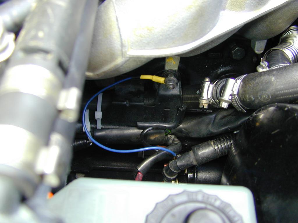

                      Update. Grounded the lead to the unloader relay. Boom, everything works again. Conclusion. Bad ground in the starter solenoid? I hate shit ghetto rigged. Can I let this setup fly for a while? Or rip that starter out and shove it up Autozone's arse? It has a lifetime warranty, so I can return it anytime I want. Like in 20 years!

                          It sounds like the unloader function in the starter is bad. Which would make me wonder about the rest of the rebuild.
