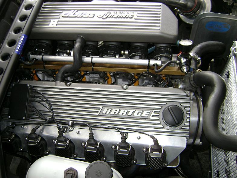

            COP may be a bit tricky with a turbo set-up due to the space constraints. Here's what I did on an NA M20....coils are from an S52 and their driven in wasted spark mode with megasquirt.

                  holy crap that is...
                  ... words do not express the level that m20 had obtained. Any more info on it?
                    that is beyond awesome man, what kind of numbers is that putting down?
                    thanks for the info too, i see what you mean about the space, im thinking of using 3 waste spark coils and custom wires and mega squirt
