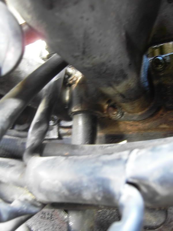

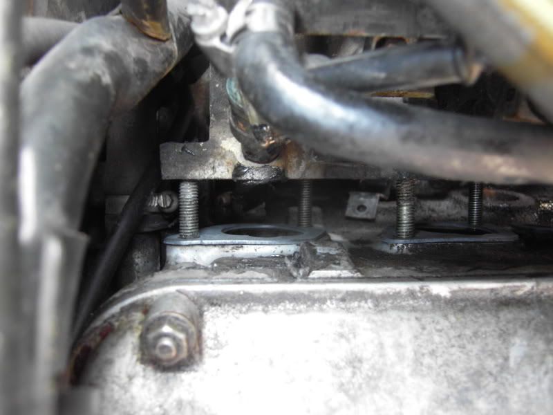

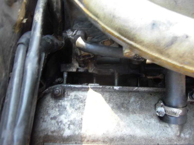

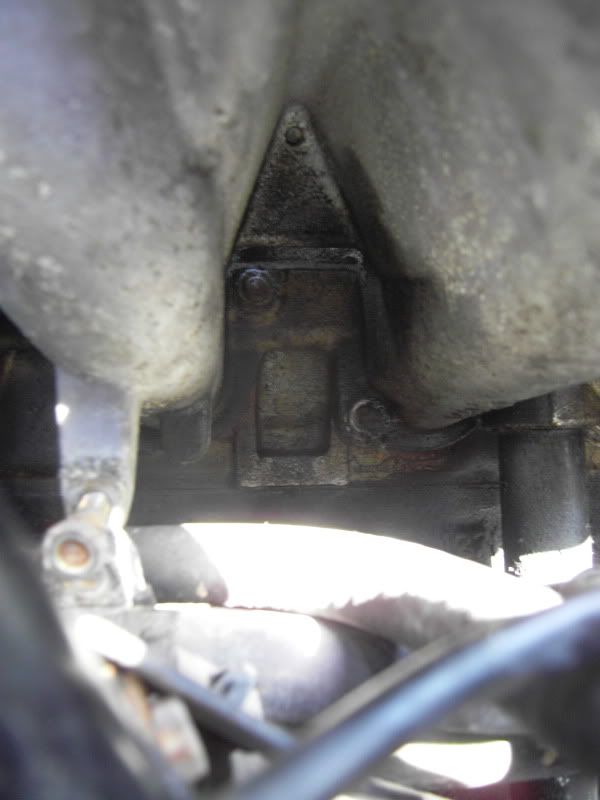

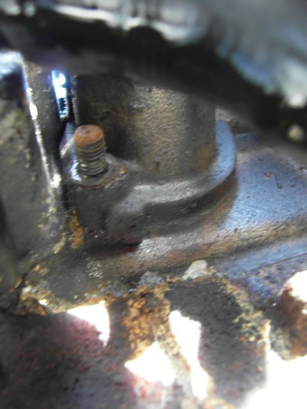

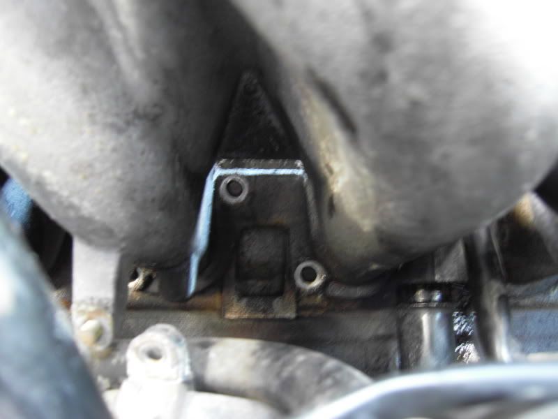

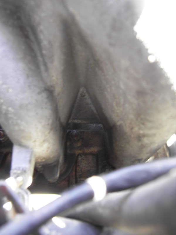

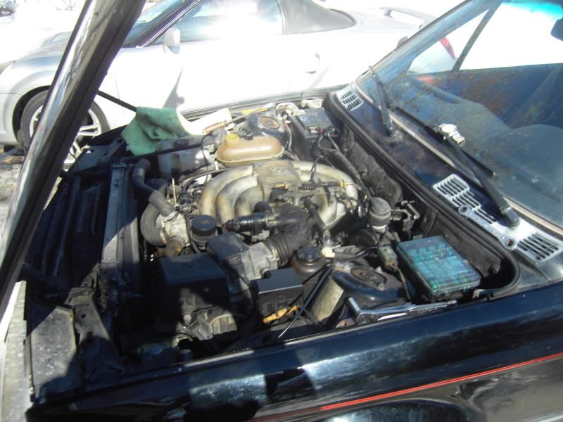

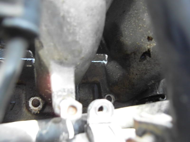

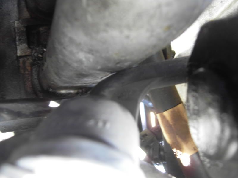

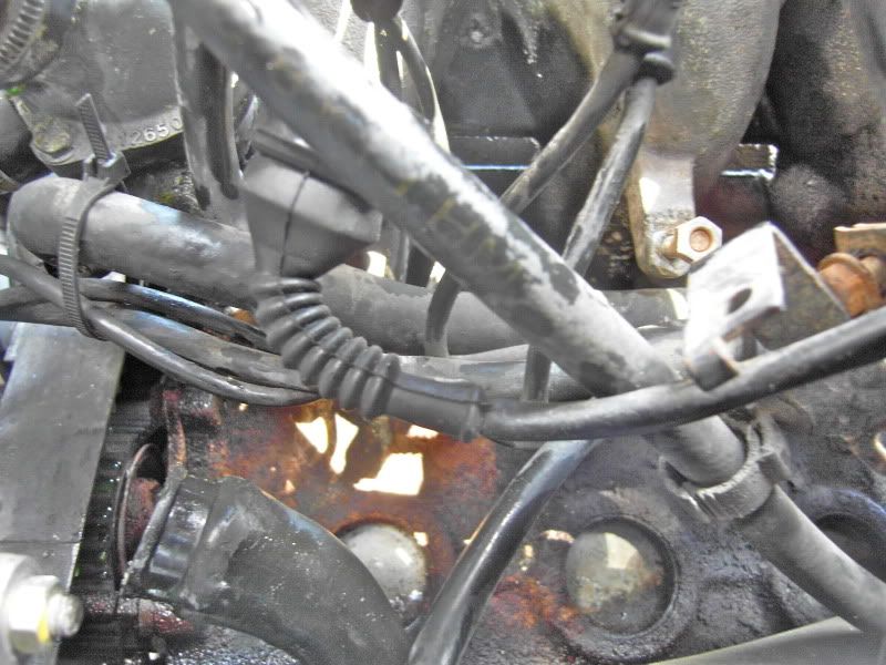

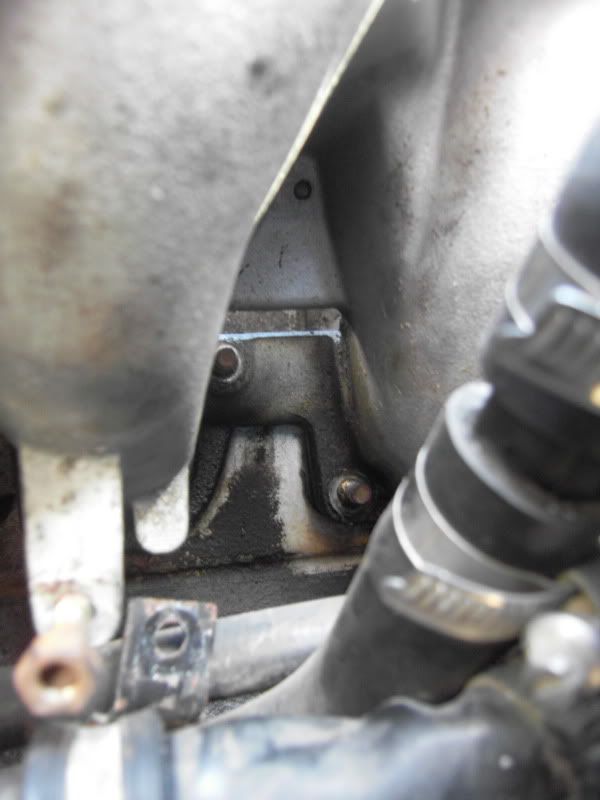

      I'm bored, prepare for pictures!
      underside of maifold - reference shot and the camera can see where I can not.
      the end ones are the hardest, this one is behind a coolant hose that MUST come off. get a gallon ziplock to catch the coolant that will spew out of it when you take it off.
      this is the next most difficult - jam a long 12mm 6pt socket with a u joint down between the manifold and the wiring to get to it.
      more reference shots.
      heres what I did to the tube to keep the spring compressed until i was done.

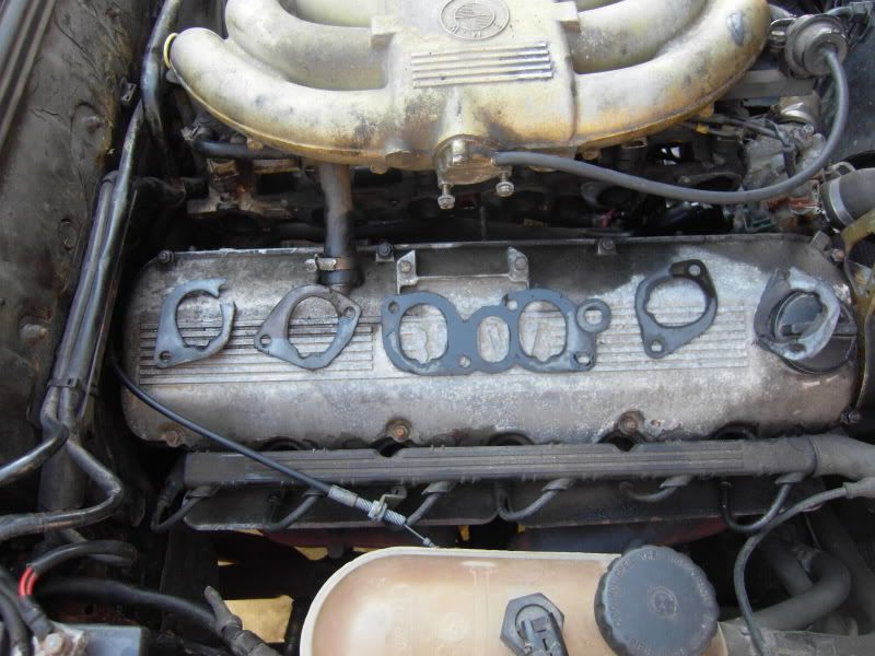

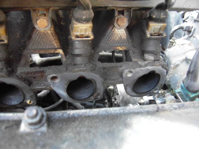

      manifold off.
      the middle most stud is long, you have to pull the manifold far enough away to get the center gasket off and the new one back on.
      old gasket - shit!
      new gasket on.
      Job done!

        nice job!
        how long did it take? im swapping mine with one that i blasted soon.

          Thanks :)
          it took me 2:00:39 start to finish which is really not bad because I actually had to refit the manifold 2 times (oil tube screwed me over)
          if you were prepared well and had the tools next to you, this is a 1.5 hour job.
          a dirty, pain in the ass 1.5 hours though :)
