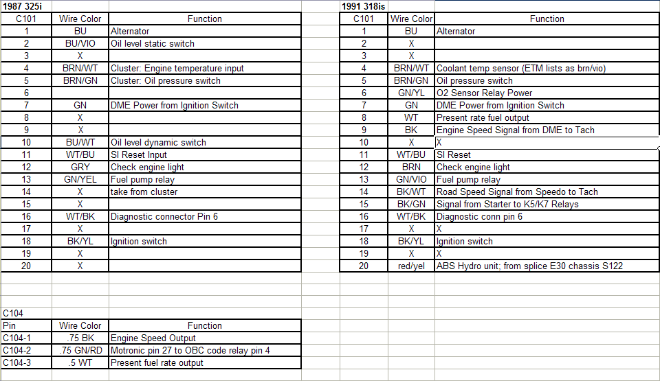

    ^ That. You're going to have to go through the wiring diagram and find out what's connected and what isn't.
    This may help you a little bit, obviously look on the right side, although I don't know how different the 318s are:

      I'm fairly certain all you need to do is hook up C104 green to a switched hot, as is already done, and the engine should operate.
      You probably just need to find out what that thick wire coming off the wiring harness is.

        open ports are 8, 9, 19, 20, 12, 3, 14, 15, and 17.
        • FredK
          • 14761
          Where's that red wire going into? The open holes you've described are fine. Those holes should not be occupied.
