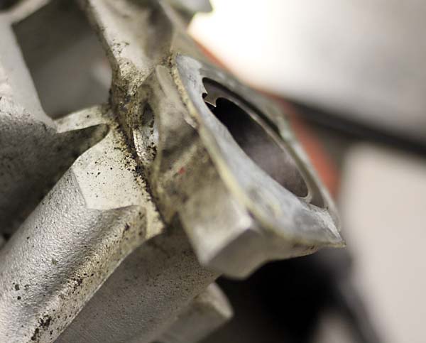

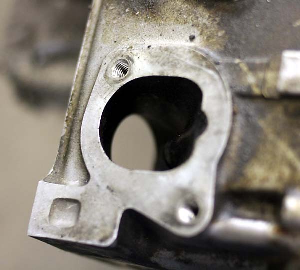

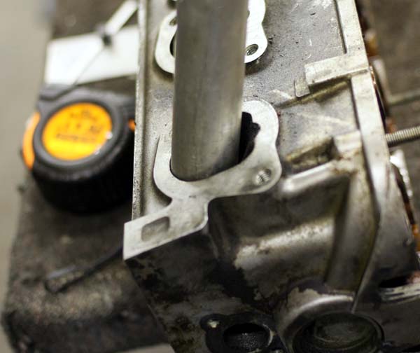

    I have been toying with the idea of building a new intake manifold and noticed that the intake air flow is 90 degrees from the mounting surface BUT when you look down into the port, it seems like the manifold should be at 60 degrees....?????
    There is a fairly sharp turn as the air leaves the manifold and goes into the head. It might be that they needed to do this to be able to locate the injectors.
    Am I missing something? Frankly I was shocked when I realized this is happening.
    Thanks, Chuck

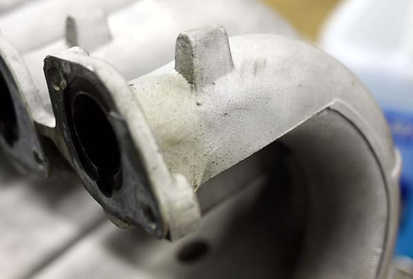

      have you looked at a B25 manifold? it's a little smoother. The B25 manifold is actually a great design from a factory, cast manifold standpoint. Most of the M20's torque curve from 3k-5k actually comes from the manifold design.
      the B27 manifold was never really meant for high power. the angle of the ports probably didn't matter that much.

          M50 manifolds are completely different; shorter runners, different helmholtz tuning, different everything. Saying it flows better doesn't mean anything.

                    So are you saying you can swap a b25 intake on an eta/seta? If so will it be an improvement?
                    [IMG]http://www.r3vlimited.com/board/
                    • nando
                      • 34839
                      well you can but the ports won't match the eta head so you'd have to port match everything.. not sure how worth it that is when you still have a single cam and ~5k redline. it's a direct fit on the seta though.
                      Build thread

                        interesting. Do you think it would be an improvement on a seta?
                        • nando
                          • 34839
                          without supporting mods (like all the other "i" stuff), no.
                            ^ like nando is saying, w/o other b25 bits its just noise
                            but with a complete b25i settup, like cam/springs and throttle body and afm, its a huge huge difference
