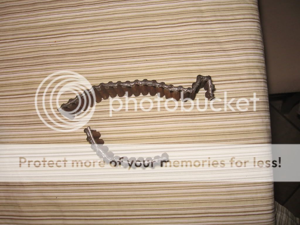

      There's a legitimate issue with them...ask me how I know I had less than 3000 miles on a recently done head gasket, timing belt, tensioner etc when my motor decided to eat itself.
      The stamped metal one has a design flaw (my seta was built 9/87 so the early setas definately have them). The later model engines had the cam gear made of cast metal. Mine sheared apart and the valves made contact with the pistons...head was trash, the pistons were salvagable though.
      Here's a thread I started about it on e30tech a few months ago.
      • GOOBER
        • 663
        Here's the pic of what my cam gear looked like. I have to say though, I think part of the reason it gave was because I did the "i' top and swap and the higher revs from beating on the car caused t to give. My reccomendation for anyone doing a "budget stroker" based on the seta is to get the cast gear - about $30 bucks new from the dealer. They don't make the stamped one anymore.

                So by your pic it's the intermediate shaft gear and not the cam gear?
                How can I identify if it's the stamped gear or cast one?
                Either way it sounds like it's time to pull it apart again. Or I could just let it go, hope the pistons don't get damaged, swap in the extra "i" engine I have and turn my "is" into a stroker...;)
                • GOOBER
                  • 663
                  you can tell by a visual inspection, they're pretty easy to tell apart. The stamped gear is solid and the cast gear has "spokes" on it and kinda looks like a wagon wheel.

                      See I agree with you abount me not replacing the tensioner but it was not the fail point here (the tensioner was perfectly intact and I replaced it with a OE one when I just rebuilt everything). The stamped metal has a design flaw, hence why the redesigned it on the later cars. I would replace it just to be on the safe side. But that's just me. Hope it works out for you. Good luck!

                        the stamped cam gears are KNOWN to fail
                        I've seen several of them fairly recently. The stamped steel rusts and crumbles.
                        There is probably a reason BMW replaced them with much beefier cast steel sprockets
