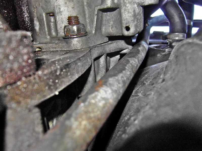

                        the bottom nut on the starter is stuck on the bolt pretty well, when I try to loosen the nut, the bolt turns with it and I can not reach the other end of the bolt to attach a socket or a wrench

                          there are 3 poles on the starter assy. which ones do I give +12 to and which ones do I ground to test the starter?
                          also, for reference, here is my bottom starter bolt, the nut sticks to the bolt too well and they spin as a unit, not loosening like they should. Can't get it out like this without taking off my transmission which is not an option.

                            Yes, you can. You can take off the intake manifold to get easier access, but I know of others who didnt.
                            • E30SPDFRK
                              • 5705
                              Get it from underneath the car. Stick a wrench on it then go back to the top and loosen the nut.
