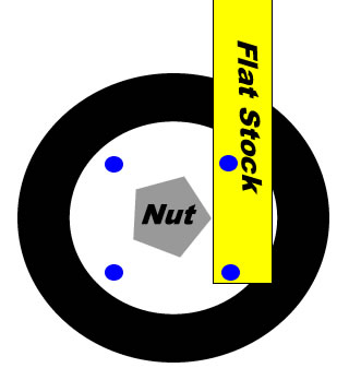

              I had a really stuck fan nut once. I took a piece of flat stock, drilled a few holes in it, then bolted it on to the pulley. I had to bend it backwards slightly for it to clear the wrench, but it got the job done.
              Those bike wrenches are cool if the nut isn't on too tightly. If the nut is rusted on though, it will destroy one of those wrenches with a quickness. I got a set of Harbor Freight wrenches that had a 32mm in it (I think that's what size this is) for about $16. Those were more than beefy enough.
                if no one in your area has 32mm, 1 1/4 inch works well also. Took the flat stock thing plus my wrench to get mine off, they can be a royal pain in the ass sometimes

                            i wedged a big screw driver between the pulley and the bolts that hold it on to keep it from spinning while loosening the nut. (same idea as the guys that used flat-stock, just simpler as most people have a big screw driver in their set of tools)
