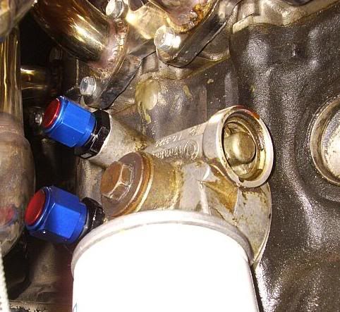

        The hardware store might have sizes but lows/homedept
        will probably just have american stuff for pipes in that size.
        I forget what size/pitch but here's a picture of a/n fittings
        with caps.
