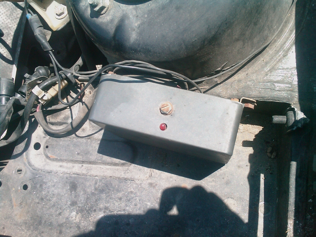

    Im trying to figure out why my car is having a hard time starting.
    im looking around in the engine bay and see this black box with a small red led on top located on the passenger side shock tower. I nvr seen this in any e30. it looks to be some sort of an alarm as two wires are going from the unit to this huge horn. the unit looks factory mounted; its wired/jumped to fuse 16 and 26. I looked at the fuse diagram and those are "not used"
    any idea what it could be?
    i will post a pic shortly...

    That just about has to be some sort of after market alarm. It may, or may not, have anything to do with your starting problems.
    If the engine won't crank or won't fire when cranking the alarm could be a player. If it is just hard to start, other causes (intake leaks, fuel system issues, spark issues, etc) are more likely.

      It's "the man" keeping tabs on you. The huge horn is in fact a microphone.
      If you unhook it, does the car start any better?

        i havent tried unplugging it just yet. Anyone know what fuse 16/21 does IF it is being used by something?

            as you can see the black box is mounted nicely like its supposed to be there. and its old...
            the horn is spliced into two wires coming from the black box...unless the horn is actually a microphone...
            the wires coming from the black box looks to be spliced into the fuse slots 16/26. that looks like a really good hack job
            you can see the black harness connected using a white 3 prong connector and from there it goes to the fuse box
            and before anyone says it, i know the o2 sensor is disconnected
            i havent removed the black box yet. ima do that in prolly an hr or so. until then moar research i suppose :wgaf:

              alarm systems dont cause hard starting, some were equipped with an immobilizer which would cause the starter to not engage or for the system to cut spark or fuel pumps (less likely)
              I would put money on your problem being fuel, spark or intake vacuum related.

                    i removed that black box...most worthless piece of crap you could put on your car. i seriously have no idea what it does. terminal 16 is ground when car is off and its +12V when the car is running. Terminal 26 is hot +12V all time. Then ground and two connectors for the that speaker thing.
