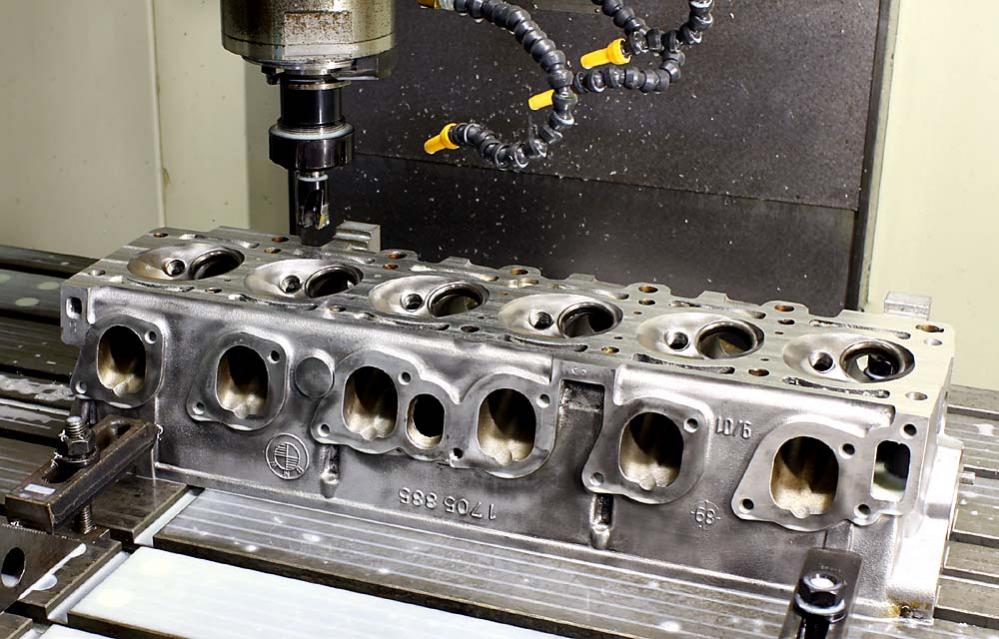

        OK, here goes. First step done
        Originally posted by jlevie View Post
        You've posted this question twice, with no definitive answers. That is probably because no one has tried this before. Try it and tell us how it works out.
        .050" milled. Next step is to cut the combustion chamber edge so the pistons will not contact the head.
        Chuck

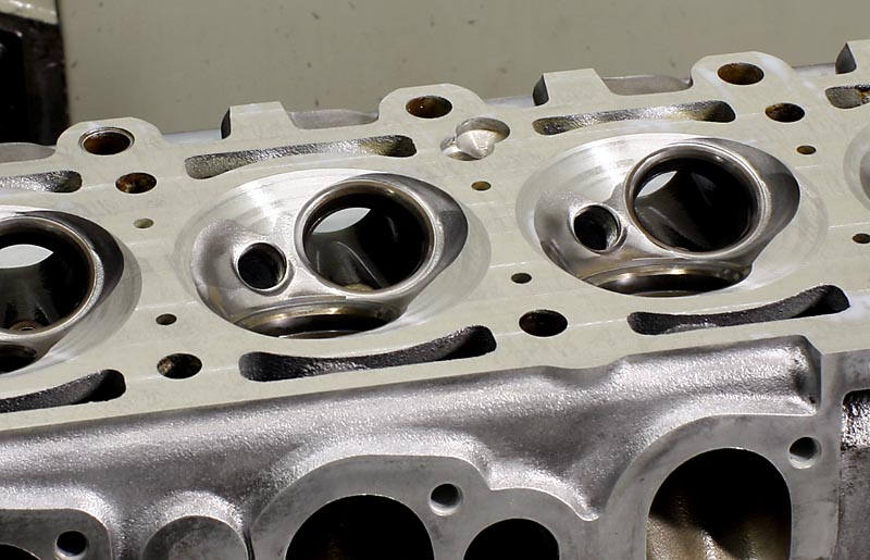

          Combustion chamber milled for piston clearance
          I am just a beginner. Hope it works

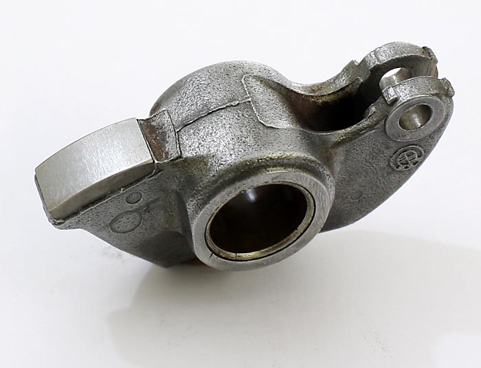

                  Going from 8.5 - 1 to approx 10 - 1 will require engine management to be safe and squeeze max power. I will also be timing the camshaft. I have also ground the rockers. See image and video. We will see :-D
                  Video of rockers being ground: http://www.youtube.com/watch?v=WAgalIMddns

                        When you mill the head, there is an area that will be hit by the piston. The area is fairly small (I did not cut the main bowl).
                        the truth is, I did kind of get lost on this: .050 off the head, .003 off the block, cleared the pistons where the valves would have hit, milled the outside edge of the piston and mill the area of the head where the piston would have hit. Soooooooo, I really don't know my exact compression ratio , BUT, I am sure I have increased it quit a bit.

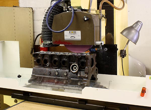

                              Ground the top of the block today
                              Ground about .003" off the top of the block :)
