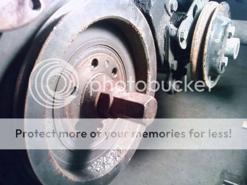

    Hi, i just bought a bmw 325 with 120k on it, so it's do for a timing belt. I bought a Chilton repair manual for the car, but i am having trouble with one detail; I have a 2 piece hub on my crank shaft, and i can't figure out how i'm supposed to get the second part of the hub off, or which way to spin the hub nut, for that matter.

    tap it a few times with a rubber mallet. It should fall off.
    and you don't need to remove the crank nut. I never do.

        It moved around a little bit.... i'll swing at it again some more, tomorrow... i have a feeling it's different for the the '87 and older m20s
          On mine there wasn't anything extra holding that on.

                It's definitely not held on there with anything other than the 13 mil bolts you've already pulled out. It is one metal surface sitting against another one though, so there's always the chance they may have rusted together.
                The pulleys are a little different on the 87 and later, but not in how they attach to the motor. Smacking with a mallet should work. If you have a 3 jaw puller, that will work too. No need to mess with the 22 mil crank nut.
                  I got it it off; a tap witha mallet, and a tough good twist with a flat head scraw driver did the trick.

                    id clean that pulley up while you were there to ;)

                      And add some anti-sieze to the back side

                        Where you need the anti-seize is on the centering surfaces. Hit them with 320-400grit crocus cloth to remove rust and then apply a seam or anti-seize.
