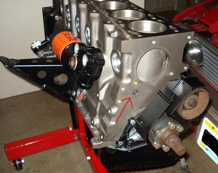

    I'm in the process of my M20 rebuild have a question about installing the plug on the front of the block just behind the water pump (location shown by red arrow in picture, part number 11111268539). Do I need to apply a sealer to this plug? If so, what type should I use? I believe this is plugging a hole from oil passage machining but I'm not certain.

      wierd, I don't remember that at all. I guess a dab of RTV won't hurt but don't glop it on there.
      and yeah, ditch the fram. the anti-drainback valves suck.

            Use thread sealant and not RTV.

              sorry to revive this thing... but how do you remove that pin?

                I'm not really sure how it was removed, the machinist at the shop did that on my block. There is also one on the back of the block in the same location.
                  yeah looks like he did it on mine too, but just the front one.
                  I made a plug from SS at work, 12mm (0.472"+-.001 on our mill ; /). i'll see how that goes when i get home. I don't want to wait two weeks for this plug to arrive. I wonder how he removed it because i have one in my old block..

                    The usual way of getting plugs like that out is to drill, tap, and use a puller or slide hammer.

                      aah wow i swear i was about to do this!! ey, there's more than one way to skin a cat. Thanks jlevie.

                      edit: 1/2" bolt, head and thread cut off, turned down to 12mm (11.97mm actual)
