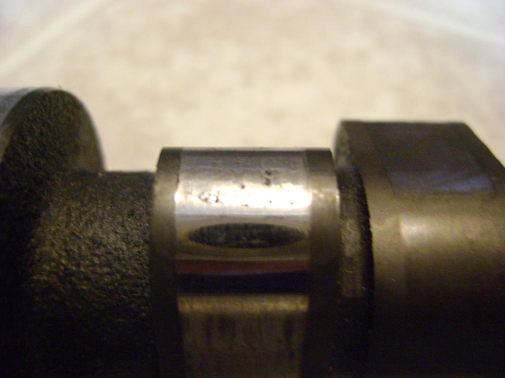

    Would you run this cam?

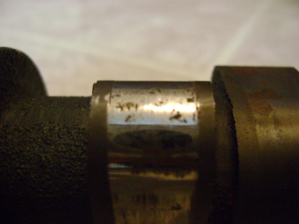

    I don't think I'll ever finish this 327 project. Bought this camshaft from another member and after two weeks of waiting this is what I received. My better judgement says "cool down, eat the $75 loss, pay for another cam and wait patiently" But goddamn I've been driving this fucking escort for close to two months and I just want to drive my babe again. Am I overreacting? Would you run this cam?

    Kind of hard to tell if that's just a bit of surface rust/dirt or if there is wear/pitting. Clean it up with some steel wool, put some oil on for rust protection and snap a few more shots.

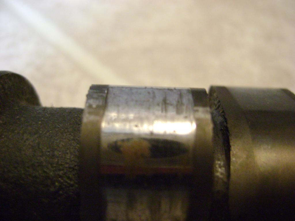

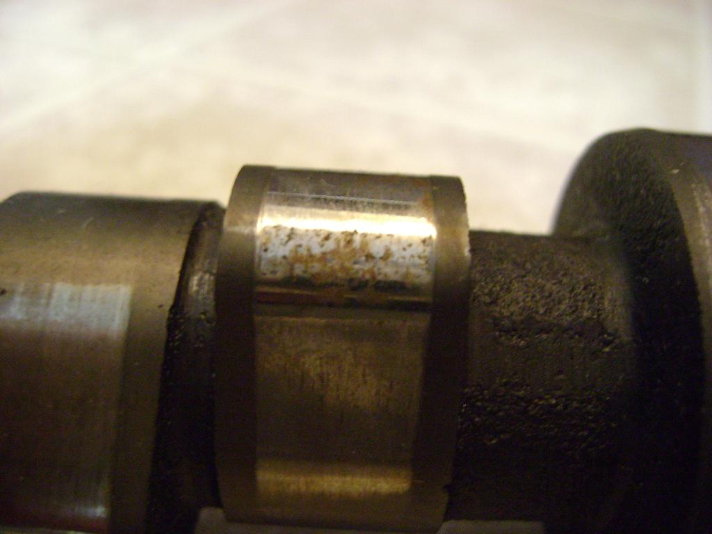

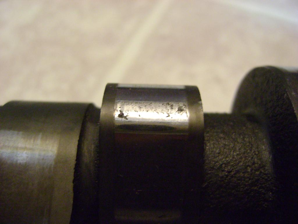

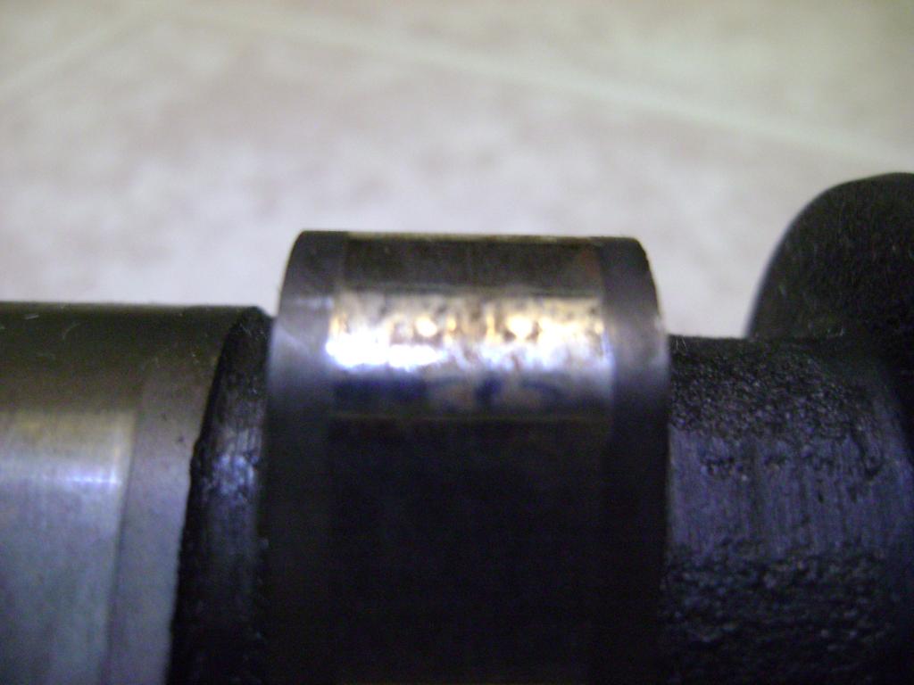

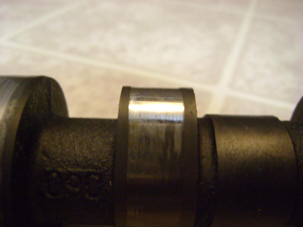

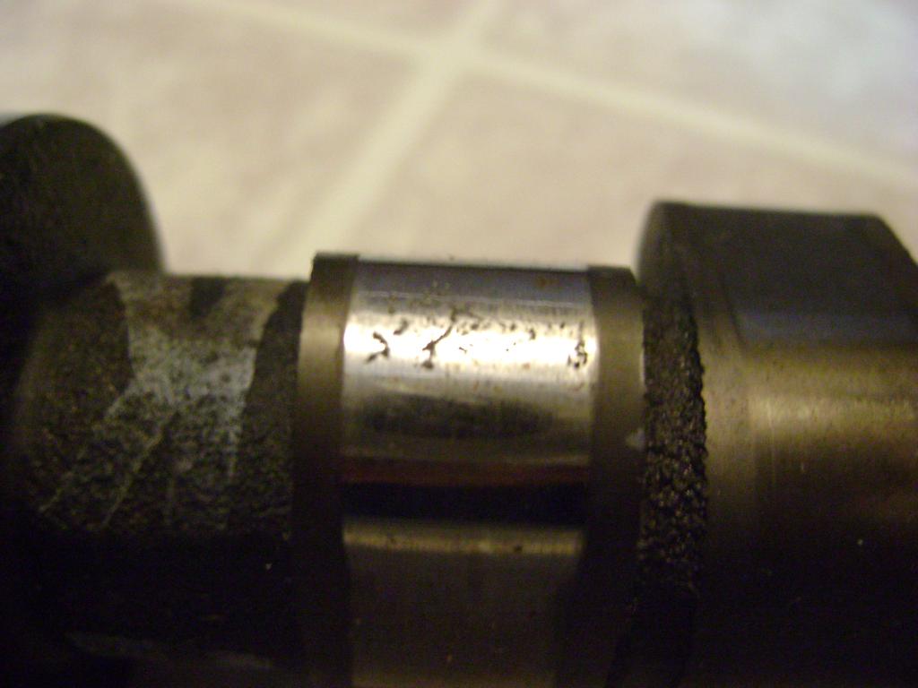

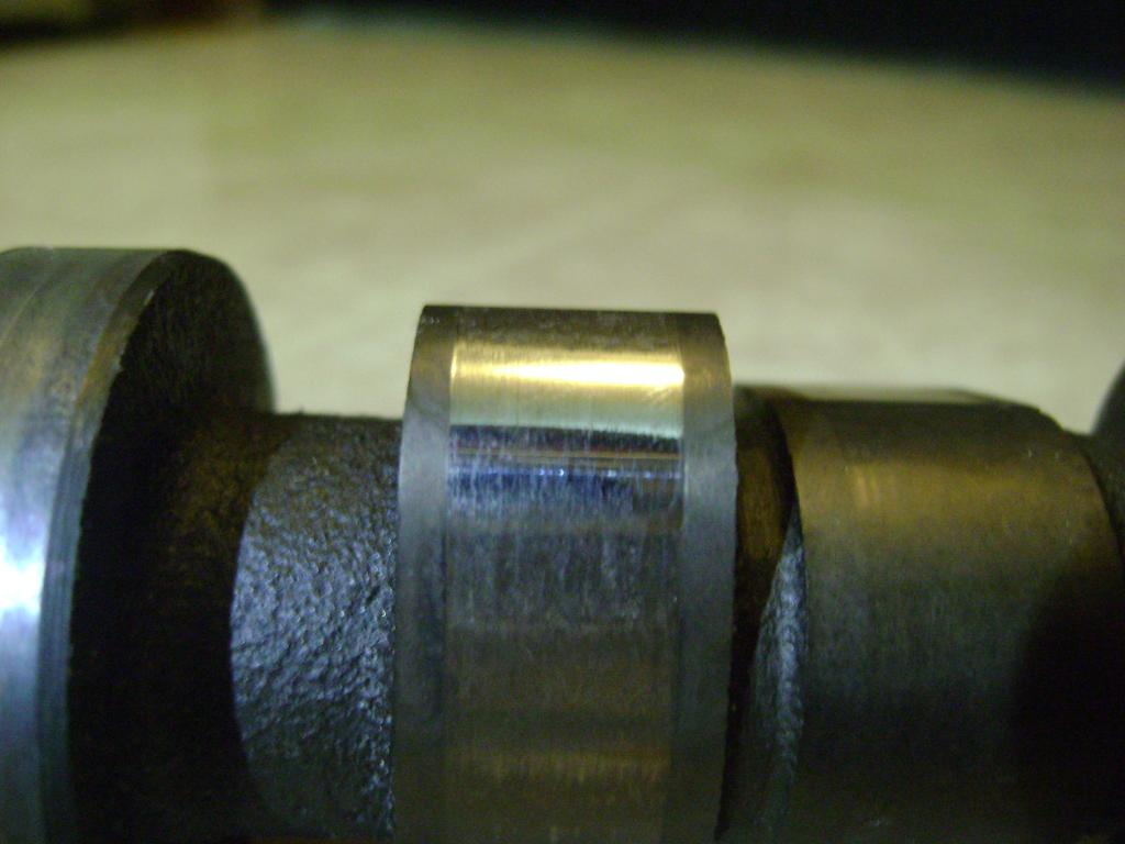

      More pics..

        Absolutely not, it is a goner and would demand your money back if it was not disclosed it was a worn out one!
        It is pitted and flat...

          no, the surface is severely scored, and the peaks of the cam lobes are worn down - just look at the big steps up to the unworn portion.
          a new stock cam isn't that expensive

                  wouldnt be the end of the world if u run it i dont think. its not perfect but its a cam and its in one peice and with the rocker eccentrics set at the correct tolerance there shouldnt be any extra play due the 1mm or so of wear.

                    no but you lose ~1mm of lift multiplied by the rocker ratio. performance isn't going to be good....

                          My guess is the rocker pads are going to have a very short life.
                          At least get it polished. :(
                          $75 isn't much. Don't use it.
