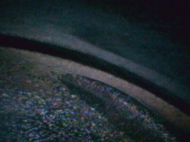

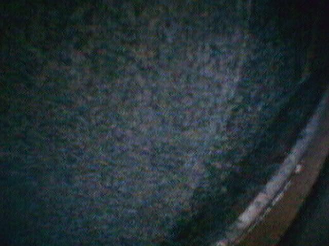

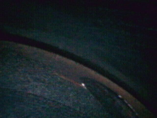

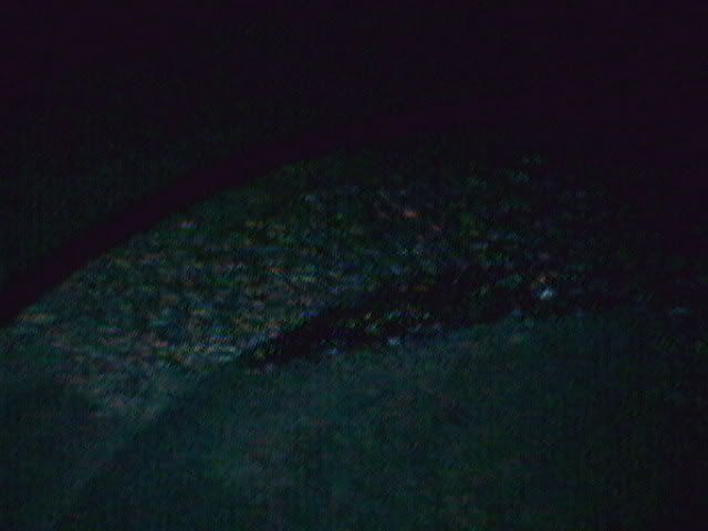

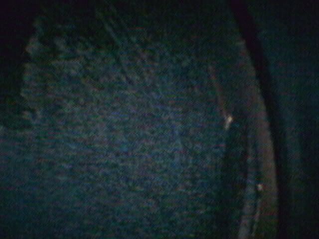

                  I was able to borrow a borescope over the weekend. It was difficult to get good images. Here are the results:
                  What do you think?
                  • SpecM
                    • Oct 2005
                    • 4531
                    looks like a flat piston = eta bottem end
                    and #200 head = eta head

                    • Cory1970
                      • Sep 2007
                      • 84
                      That is what I thought, oh well such is life.
