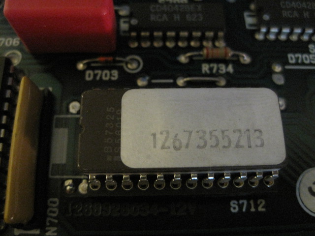

    Newbie who just picked up an '87 es 5-spd. Spent most of the last 2 weeks searching/reading a few of the E30 forums (luckily work has been slow :D ) but haven't been able to find a full answer to one perplexing questions on the new ride...
    How can I tell if I have a chipped ecu?
    Before anyone says 'check the label' - already did that and it doesn't help... There is a white sticker about the size of the chip, with nothing written on it (or whatever was on it has been wiped off).

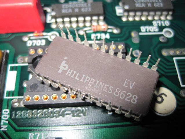

    Is there a way by just looking at a chip if it is stock or aftermarket? Do any of the aftermarket ones have some tell-tale indicator on it or something that is not found on the stock ones?? Country of manufacture? (my chip says 'made in Philippines on the bottom).

    Take a pic of the said chip and post it up. I should be able to tell by looking at it.
      Will do tomorrow, or possibly tonight (I DD the car now)
      In the mean time, anyone have pictures or can take pics of both stock and ebay/aftermarket chips so I can see what the difference looks like?

        all of the stock ECUs i've taken apart have had a generic brown chip in them with some numbers written directly on the chip, never a sticker.
        Moral of this story?
          Here the pics be...
          I guess there is something on the sticker... for some reason I missed that number on there the other night...

                    Anyone have pics of an ebay chip for a 027 ecu?
                    eugeman? can you tell what it is from my pics?

                      I'm looking right at 3 different chips for an m20b27 on my desk. That is a stock eta chip you have. 100% identical to the one I have, except mine says "Malay" instead of Philippines. Same sticker, same number.
                        Thank you for the confirmation.
                        Now I can add a chip to my wish list and start the tune-up / mod process!
