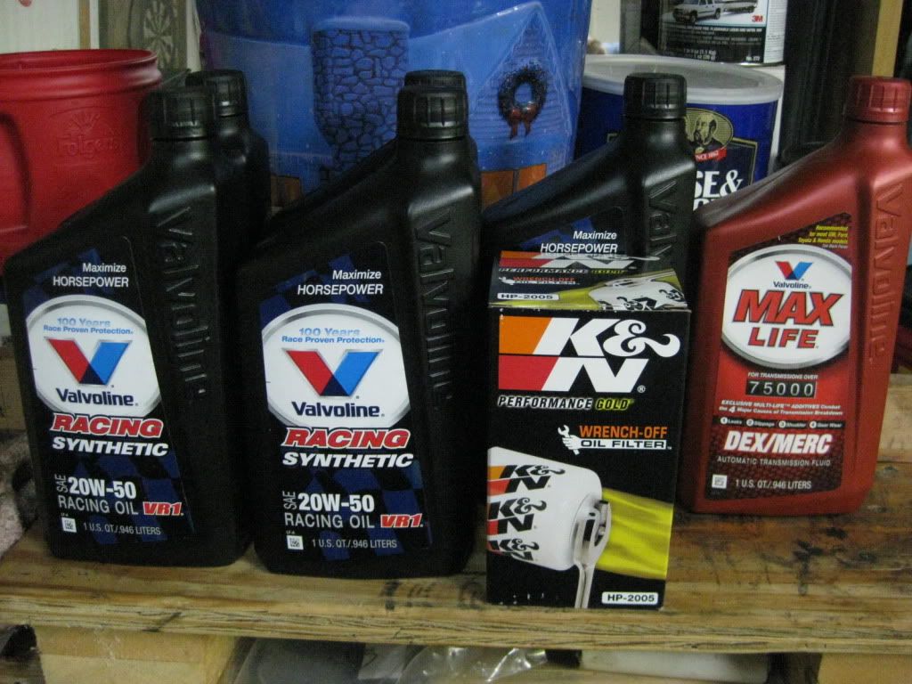

    just because i am not sure...what is the best oil for break-in. running royal purple 15w50 after that.
    • manjambles
      • 125
      royal purple makes a great engine break in oil
      • riceh8r
        • Dec 2010
        • 133
        just want to make sure the rings seat well
        i am leaning towards kendall gt-1 20w50

            went with valvoline racing oil and a k&m filter. .2% zinc, highest out there.

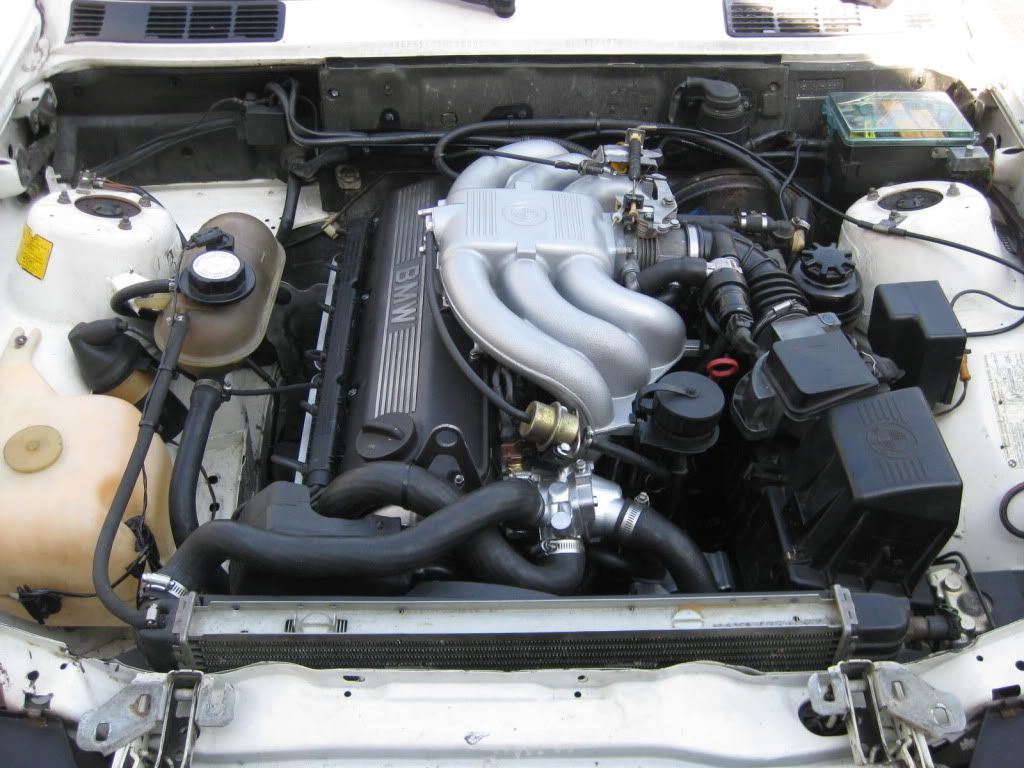

            engine bay is complete...

                I was always told you should never break in with synthetic. I always use the cheap Walmart 20w-50 which actually is halfway decent and has high zinc content. Then at 1000 miles switch to synthetic of choice.
                Interesting choice to install the intake, front covers, etc. after dropping it in...I always find that stuff much easier out of the car. But if that worked good then that's cool!
