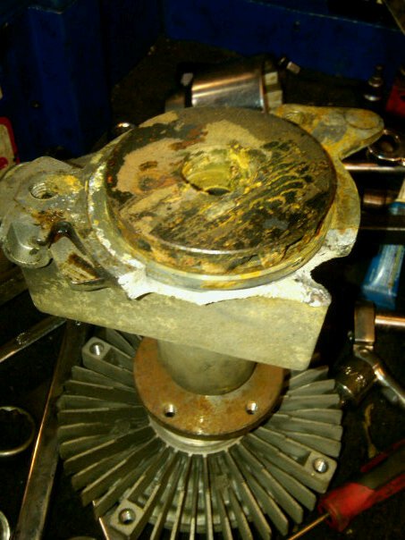

PO did the timing belt/water pump, valve adjustment way earlier, all belts, and fixed the a/c.
At anything above 4k rpm one or more of the drive belts were squealing really bad, just by hand the one on the compressor and water pump was loose....28 bucks for three new belts and my family friend/mechanic replaced them in an hour and a half.....
I take it out for a test drive, squealing is gone, engine sounds quieter right out of the lot. Something strange was occurring, my temp gauge was steady as can be and actually giving normal reading from cold at start up to warm running temp on the road.....So I figured maybe the added tension that wasn't there before was making my pump and cooling system flow correctly...
After testing like 4 times in the higher rpms it was running amazing. Way better then before, AND my temp gauge was no longer fluttering around and dependent on me tapping on the cluster to make it click into place.

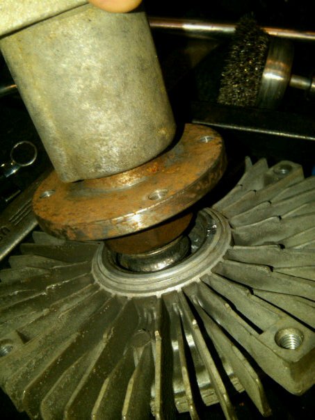

I go to head home and POP loud bang and vibrating noise thats heavily rpm dependent....after listening to it idle slowing from like 40 with the clutch pushed in....idle was fine and no noise.....
Barely puttering under 2k I pulled into the closest road and then....It puked all the coolant out from around the water pump area, the fan clutch was loose as can be, My guy said it could be a hose, radiator or both..worst case scenario maybe the water pump....
Sound normal? why would my temp gauge be reading normal after a belt change? Maybe the pump wasn't spinning? possible I over heated?..I don't think I over heated though, was on the road for 30 seconds after it happened...
My first e30 and my first 'major' break down and I'm nervous as hell to see what the diagnosis will be tomorrow...Looking for some outside words of advice and or possible outcomes from anyone here with some knowledge on the coolant system
