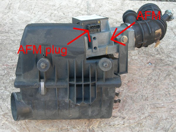

            What is afm? Im a noob.

              air flow meter next to your air box

                Is it the plug on the air box?

                  The Air Flow Meter (AFM) uses a combination of a sprung door and an air temp sensor to measure the mass of air entering the engine at any given time. See attached picture (grabbed from a Google search)...

                    So unplug it and try to start it? And if no start then there is something wrong with the plug? Will it need to be replaced?
                      Yeah. Try starting it with the AFM plugged in, and make note of how it tries to start. Then, unplug it and try to start it. If the no start situation is exactly the same, the AFM might be your problem.
                      Not necessarily, it still might be something else. Also, the car WILL NOT start without the AFM plugged in, it's one of the two major inputs to the ECU. The way my thinking goes, if the no start stays the same without the AFM, that might be your problem. This is in no way a definitive test.
